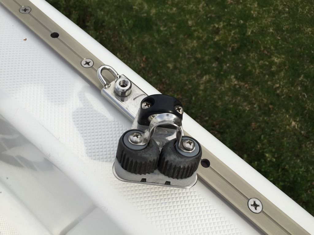

I use my 150 jenny 100% of the time. They are sheeted to the cockpit fairleads, never to the cabin top fairleads. Can't imagine how you'd do that with a jenny.
Then again, I never use the winches. I have EZ-cleats:
and don't even leave the helm to tack my jenny. Best mod ever.

Dittos on the EZ Cleats...I never use winches with my genoa or jib. I do plan to break out the asymmetrical this summer....I am pretty sure the same cleats will work great here as well. The only problem I ever have is the jib sheet occasionally getting fouled on my mid-cleat. Has anybody ever seen those cool "snap closed" mooring cleats that work with the rail?

And Tritto (?) on the EZ cleats. 8)
Baha wrote:Dittos on the EZ Cleats...I never use winches with my genoa or jib. I do plan to break out the asymmetrical this summer....I am pretty sure the same cleats will work great here as well. The only problem I ever have is the jib sheet occasionally getting fouled on my mid-cleat. Has anybody ever seen those cool "snap closed" mooring cleats that work with the rail?
