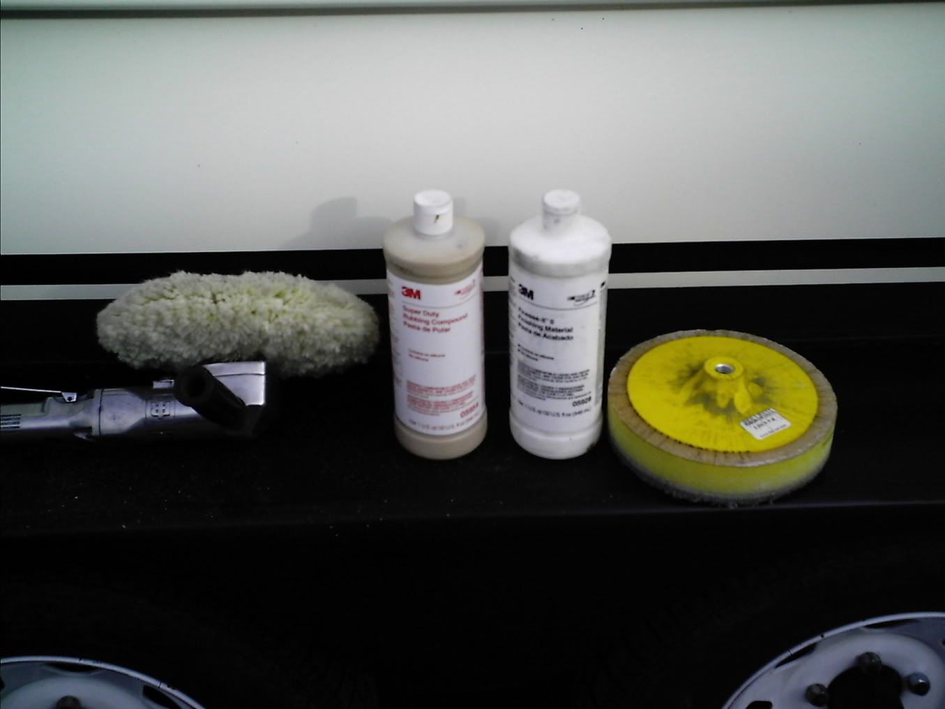

For gelcoat wax/compound/polish I use and recommend a good DA polisher with appropriate pads. You will use less product, get better results, faster than you ever could by hand.
I was very anti-machine for years..once I tried it...I couldn't belive how fast I could do the job...as well getting far superior results.

I agree with paul. Softscrub is good for removing mold but a good polish is better for shining up your boat. If you have bad oxidation use a good compound followed by a polish.
I use 3m compound and polish available at any auto paint supply and most tool outlets.
