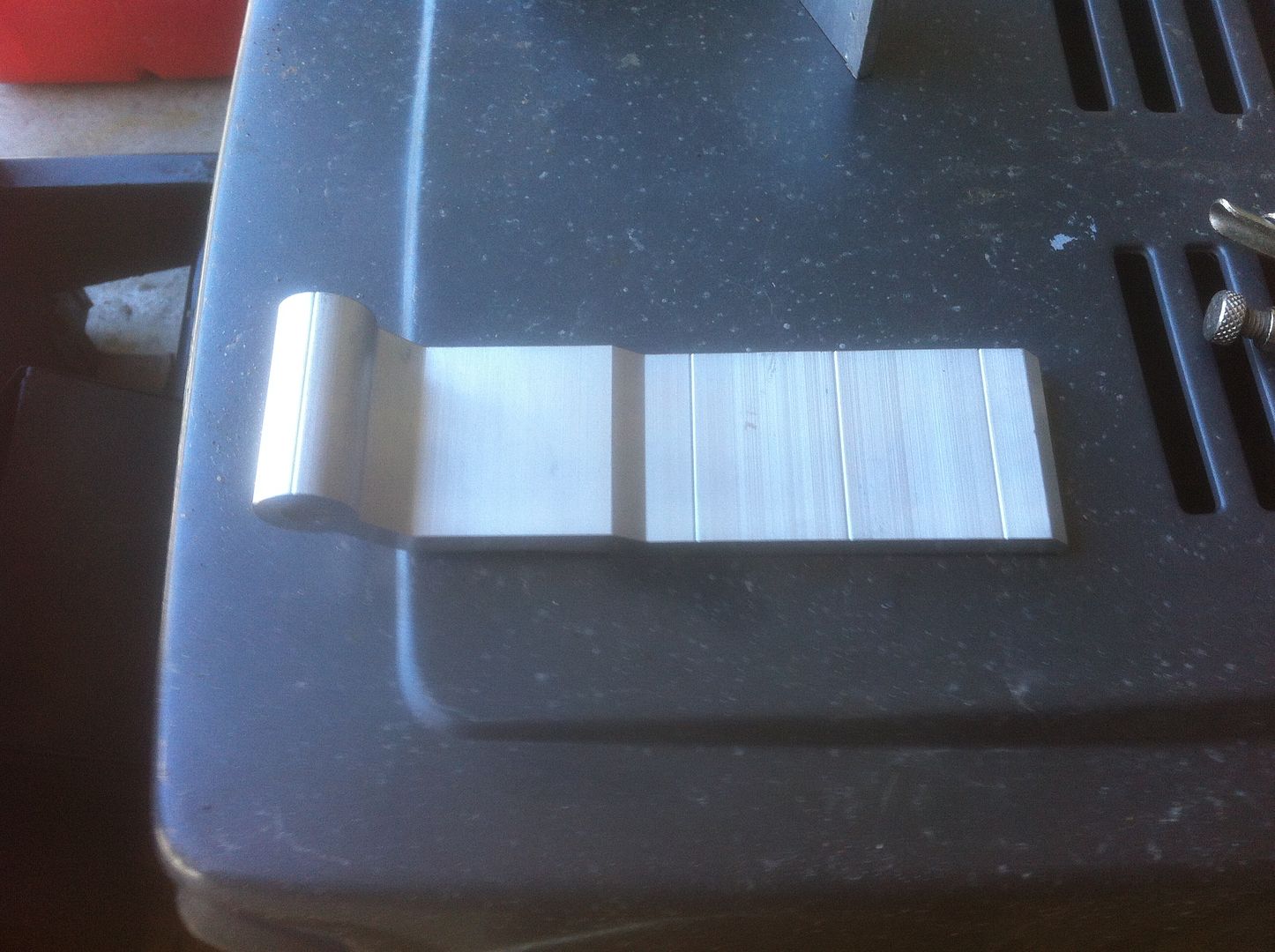

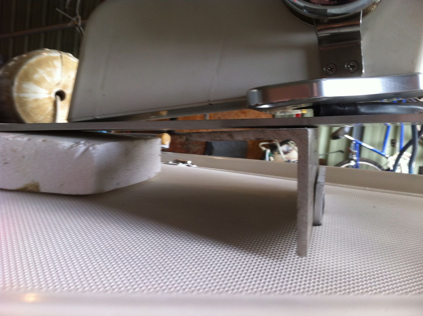

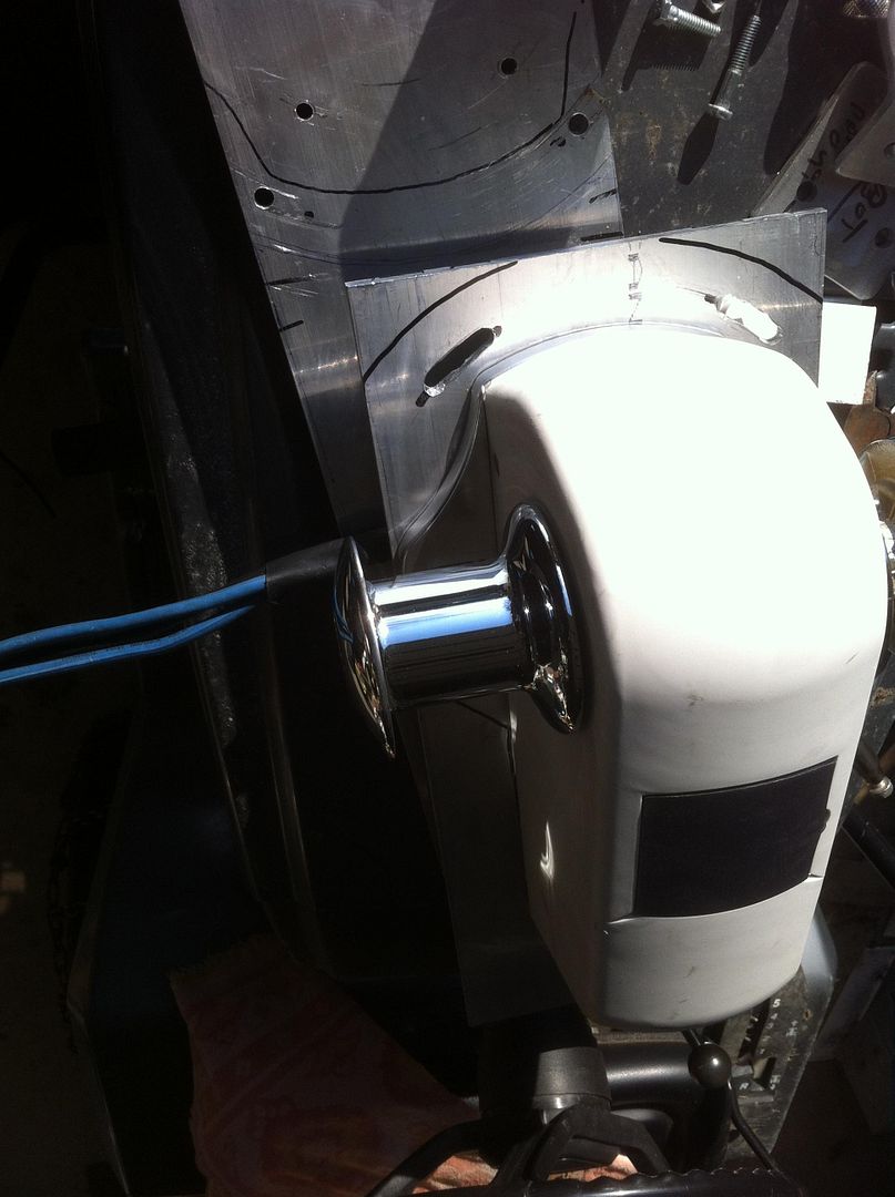

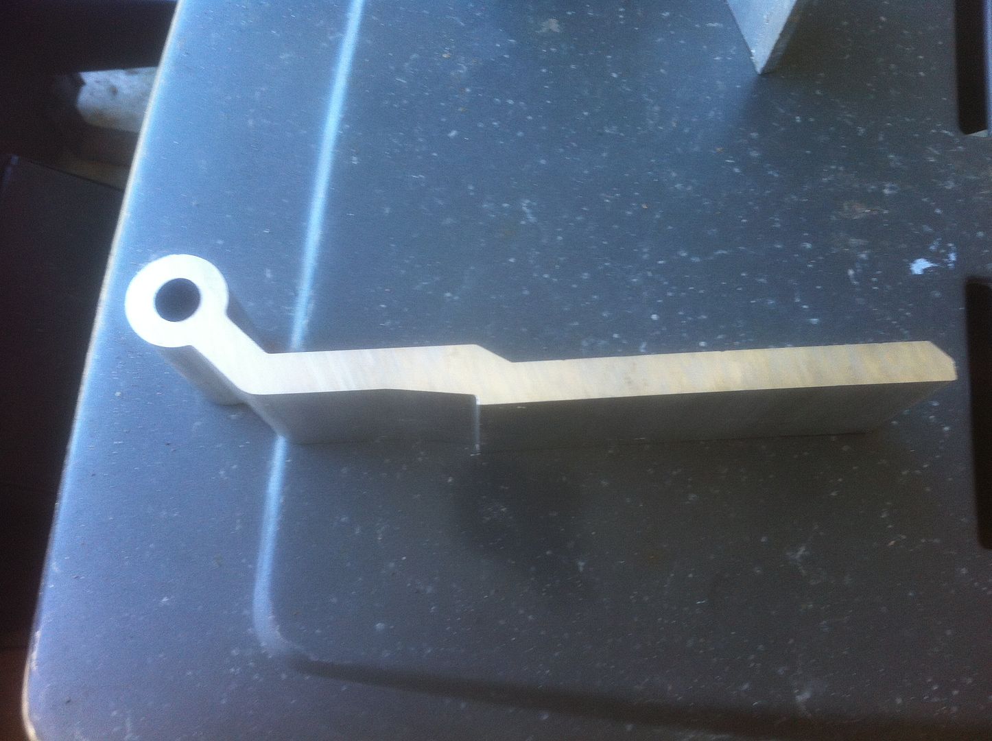

cut this hinge into 2 sections make two hinges
http://i844.photobucket.com/albums/ab1/ ... 28e7da.jpg
http://i844.photobucket.com/albums/ab1/ ... b66389.jpg
http://i844.photobucket.com/albums/ab1/ ... ed52fc.jpg
http://i844.photobucket.com/albums/ab1/ ... 331e9e.jpg
http://i844.photobucket.com/albums/ab1/ ... d246d1.jpg
http://i844.photobucket.com/albums/ab1/ ... aee94d.jpg
http://i844.photobucket.com/albums/ab1/ ... fb5448.jpg

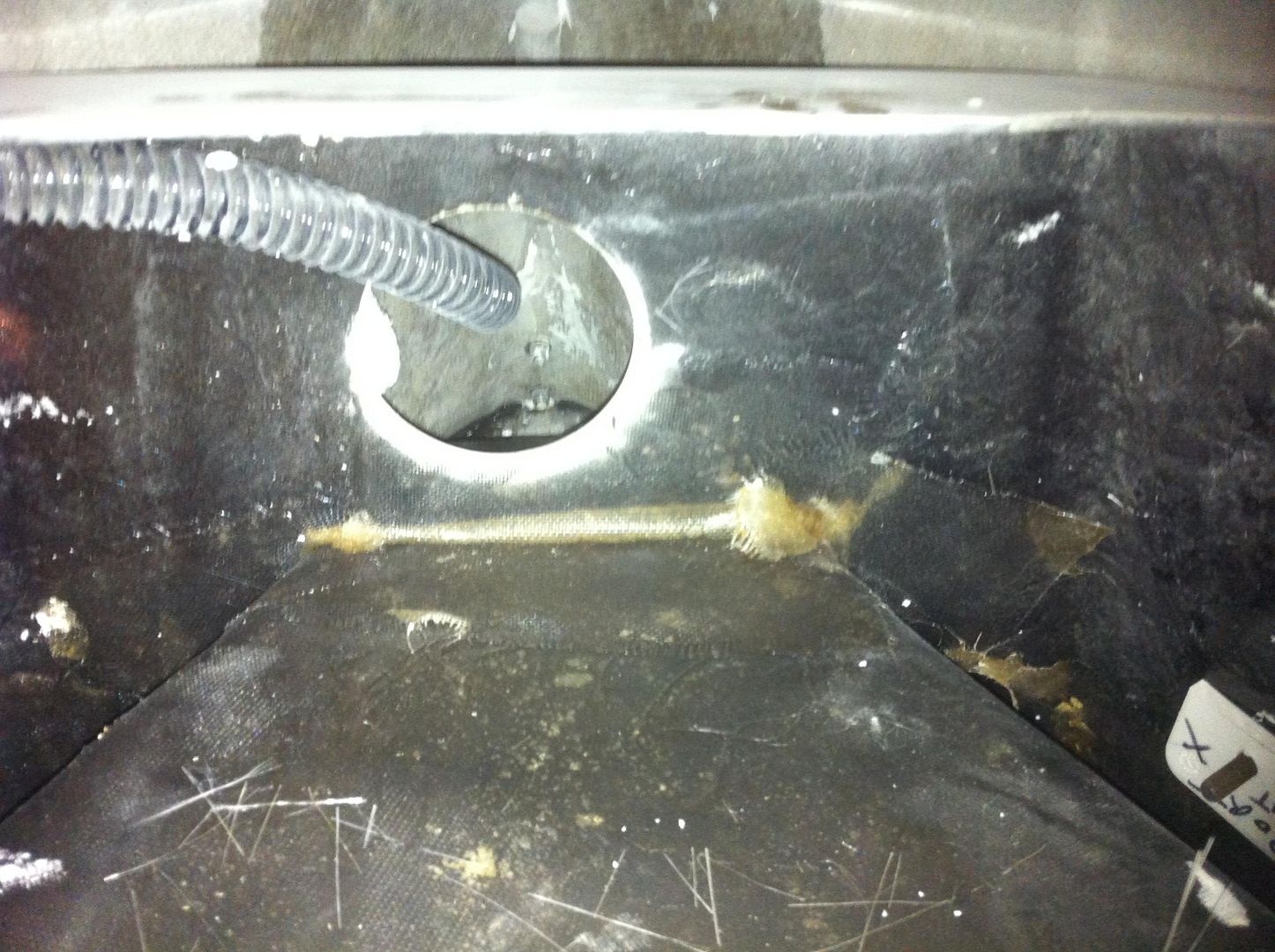

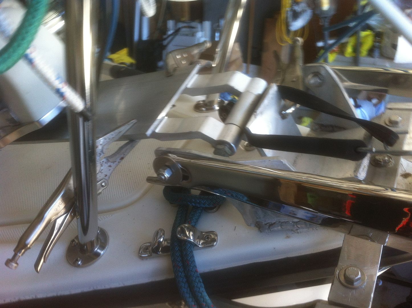

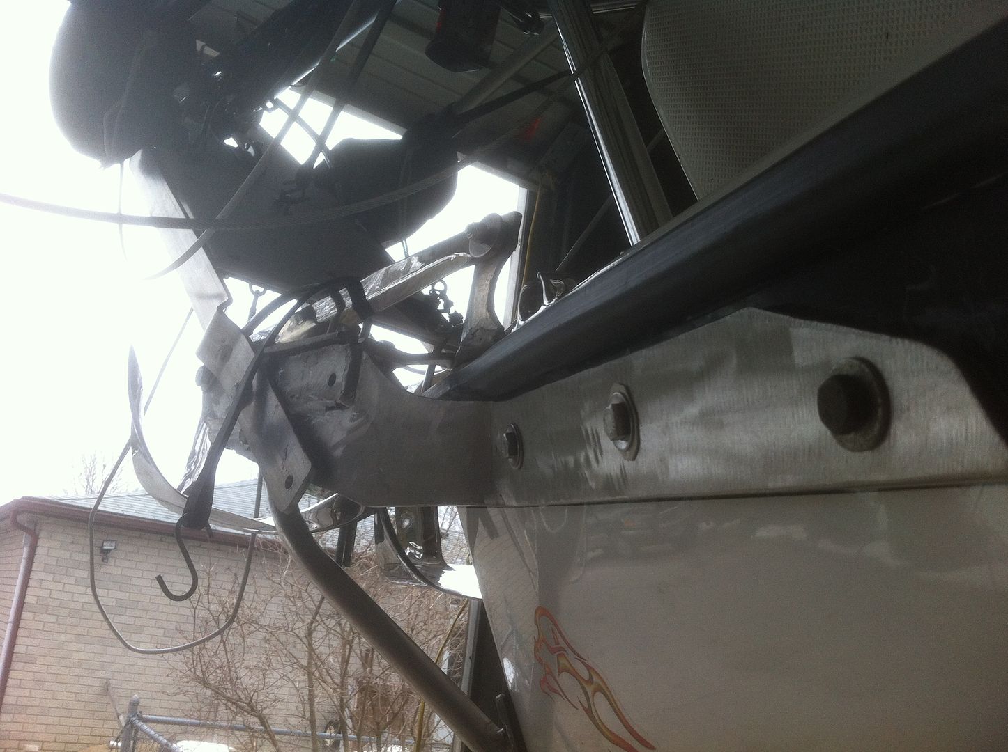

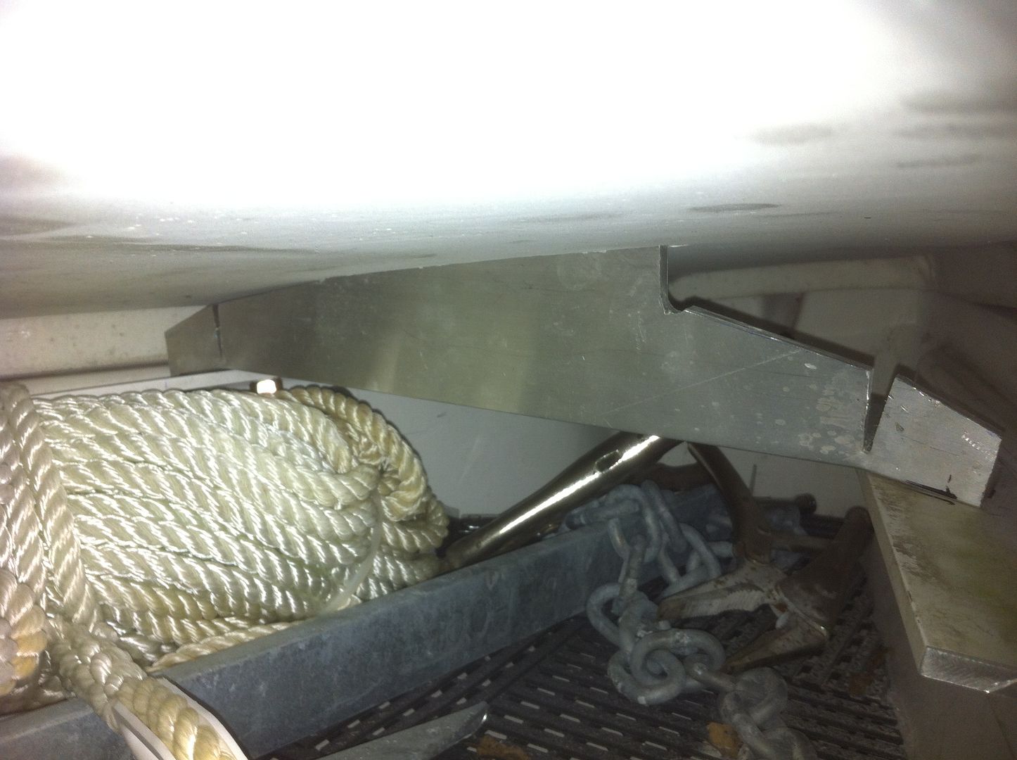

Here on the port side the aft ss bolt was removed from the bowsprit / anchor roller mounting brkt to temp install a black reg 3/8" X 3" bolt for installing the stiffner brkt's from there to the ancor locker
http://i844.photobucket.com/albums/ab1/ ... 64cc9d.jpg
here is the inside veiw from underneath of the floatation chamber that surounds the ancor locker u can see the stiffner brkt installed between the hull & the ancor locker this will all be attachhed to the rear mounting brkt . the right bolt is coming through from the ancor roller mounting brkt & hull then accross to the ancor locker sidewall this means everything is attached to the deck & hull below the deck hull joint thus releaving any stress from the deck hull joint
http://i844.photobucket.com/albums/ab1/ ... 2c20c6.jpg

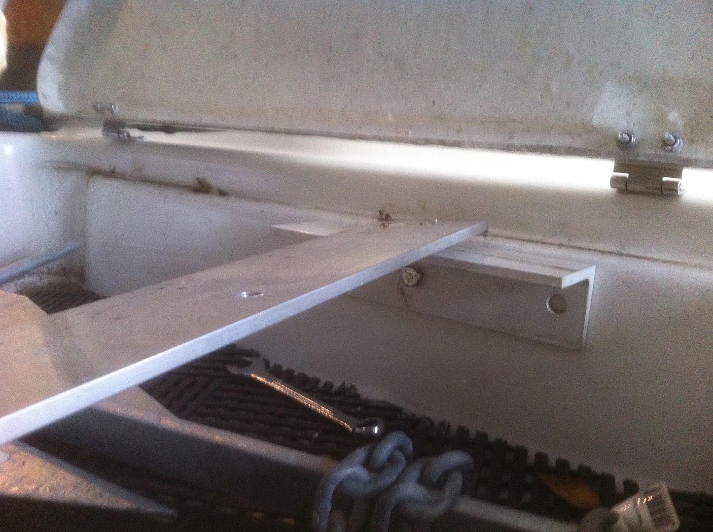

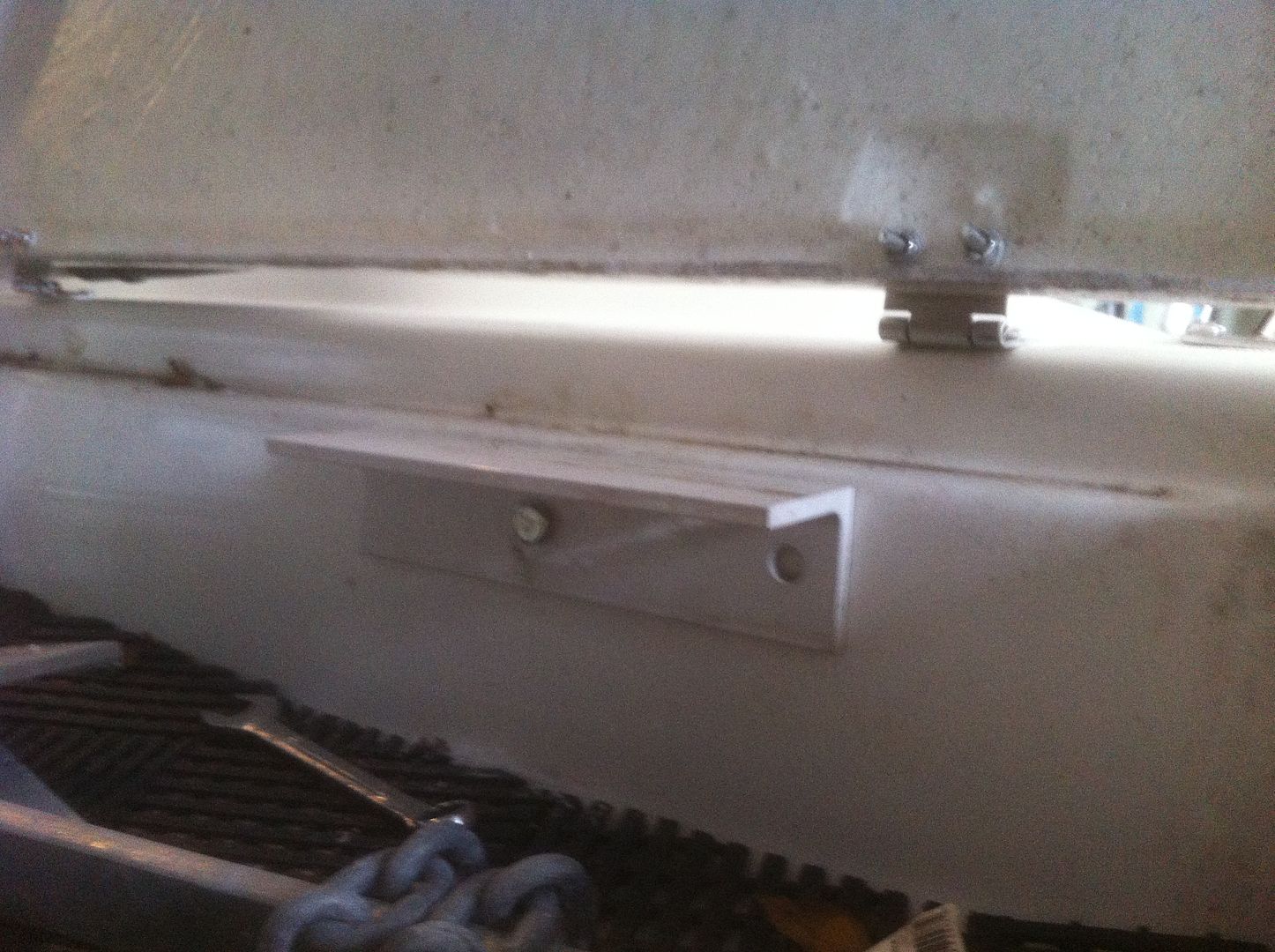

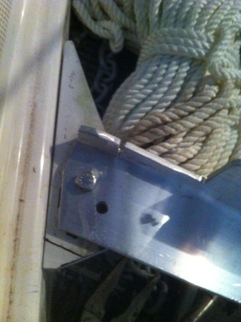

inside ancor locker side mounting brkt to be cut once postition of cross brace angle is determined
http://i844.photobucket.com/albums/ab1/ ... 9875a2.jpg
The cross brace will be 3" allum channel , here shown is 3" alum flat bar as a demo
http://i844.photobucket.com/albums/ab1/ ... 4d5644.jpg

this is all just temp. installed once fitted properly then have to make sure these brkt's will fit the starboard side before marking & drilling the S/B side brkt's & once the inside ancor locker angle mounting brkt's angles have been determined & measured everything will have to be removed to cut these brkt's
then checked for exact fit then all re-installed this part of the process is very time consuming climbing in & out of the boat a hundred times
, then onto the front brkt for completion & installation a little more accessible up front above the bow eye access panell the ancor locker brkts r accessed through one 5" round access panell on each side a big pita I may see if I can buy a wall access panell from home hardware the kind u buy for ur house walls for about 20$ be much easier for further access & re-installing the floation

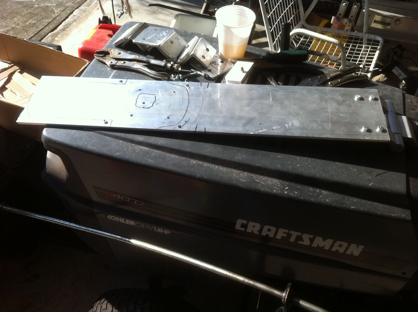

Progress was slow this wk-end , bought more Alum material 65$ , SS hardware $130.00 fri morn , then spent the rest of Fri & Sat with my Daughter & granddaughter
So back @ it on Sun morn started with a peice of Alum Angle 6" X 6" 3/8" thick for the front mounting brkt
http://s844.photobucket.com/user/TheHig ... sort=6&o=0
http://i844.photobucket.com/albums/ab1/ ... f22ae3.jpg
http://i844.photobucket.com/albums/ab1/ ... 063342.jpg
http://i844.photobucket.com/albums/ab1/ ... 9e7293.jpg
http://i844.photobucket.com/albums/ab1/ ... fb9ee2.jpg

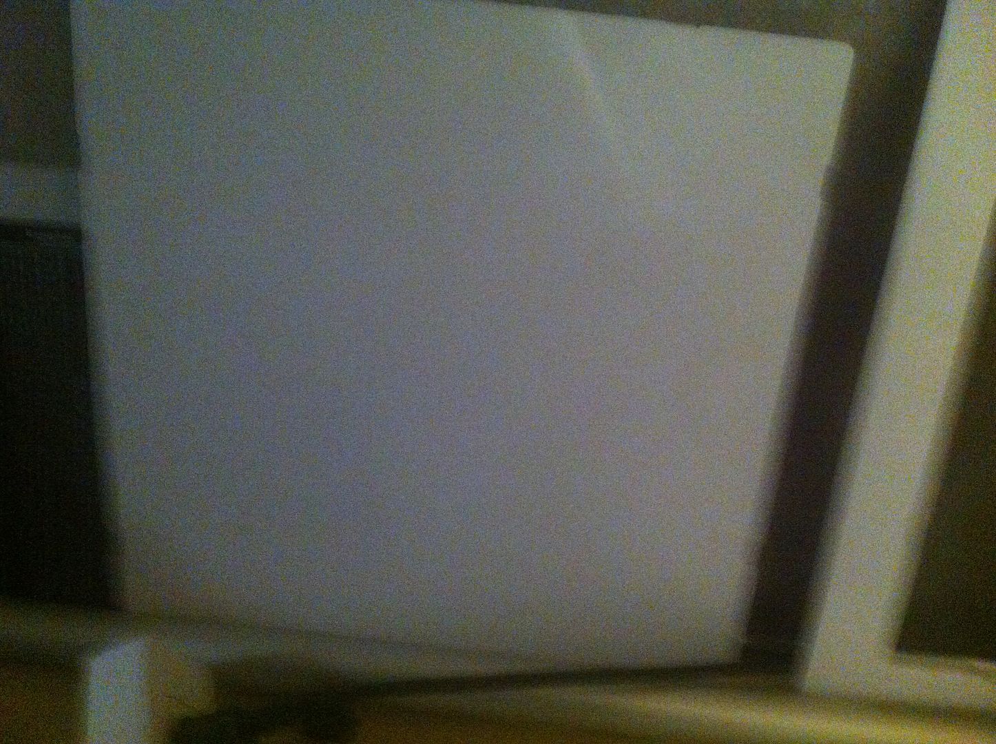

The panel lid
http://i844.photobucket.com/albums/ab1/ ... 3aa1bb.jpg

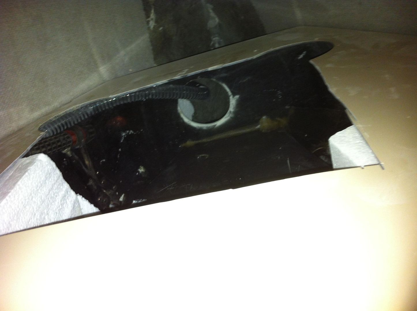

Here u can see the peice that came out of th slot cut out as u can see the anchor locker lid has a balsa wood core so after I cut the slot out a little more wider then it will have to be resin core the edges to seal them from the water

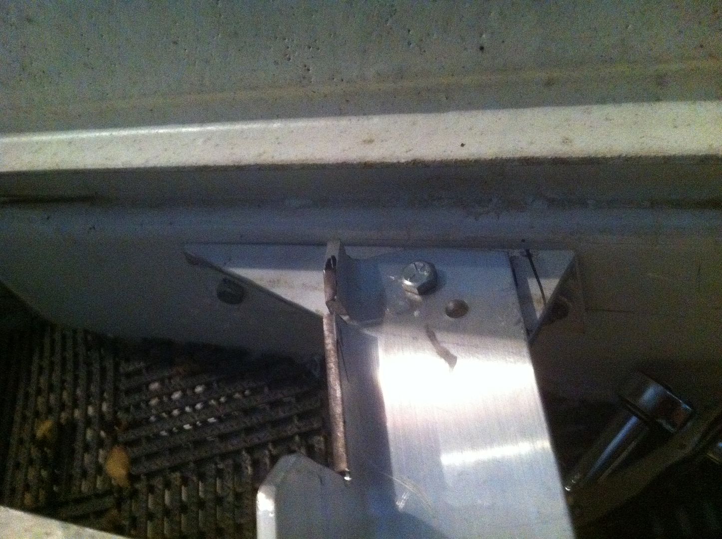

Well bought more material 16" X 3" x3" x 1/4" thick Alum Angle yesterday Fri , & today sat got right back into it freezing my butt off inside both my shops as I'm toooooooooo, cheap !! to heat the joints !!
anyway made & finshed off the inside brkt's for the anchor lock
http://i844.photobucket.com/albums/ab1/ ... ab1187.jpg
The brkt looks un-even & lop-sided just due to the angle the pic was taken
http://i844.photobucket.com/albums/ab1/ ... e8d619.jpg
S/B inside locker side brkt
http://i844.photobucket.com/albums/ab1/ ... 0e3e44.jpg
port side inside locker brkt
http://i844.photobucket.com/albums/ab1/ ... a93c4d.jpg
httNew one peice inside locker center brkt
http://i844.photobucket.com/albums/ab1/ ... 036e50.jpg
http://i844.photobucket.com/albums/ab1/ ... b61ff6.jpg

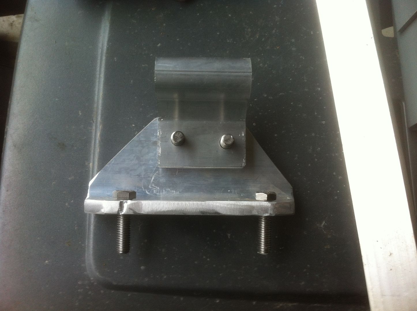

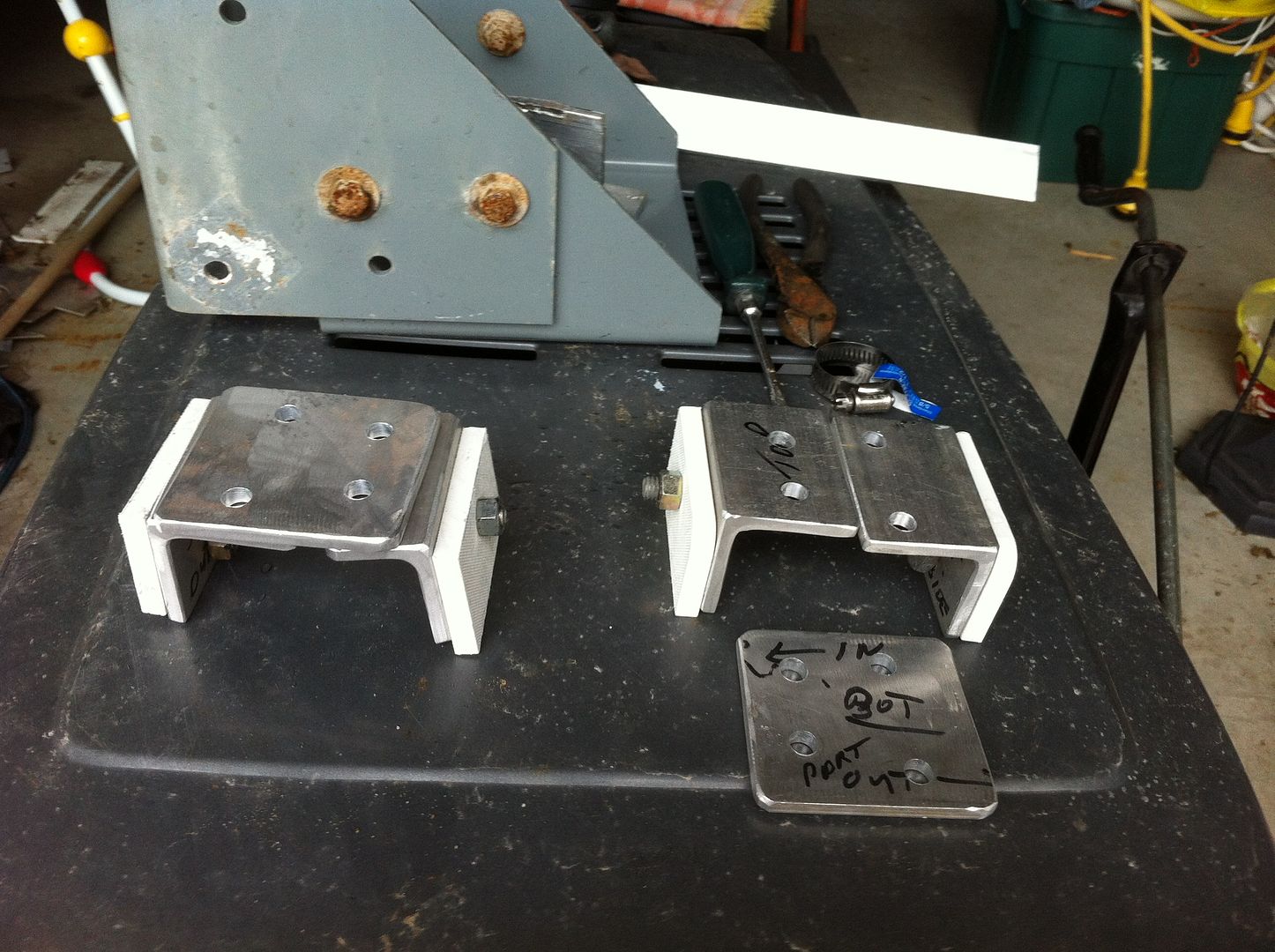

This is the complete brkt's assembly it is a 9 peice alum brkt's & 4 plastic "cutting board" backing plates that once assembled altogether inside the boat it all bolts together bringing the hull on both sides & the anchor locker walls making them a one peice assembley so their is no stress on the deck or deck joint
http://i844.photobucket.com/albums/ab1/ ... 9a88cc.jpg

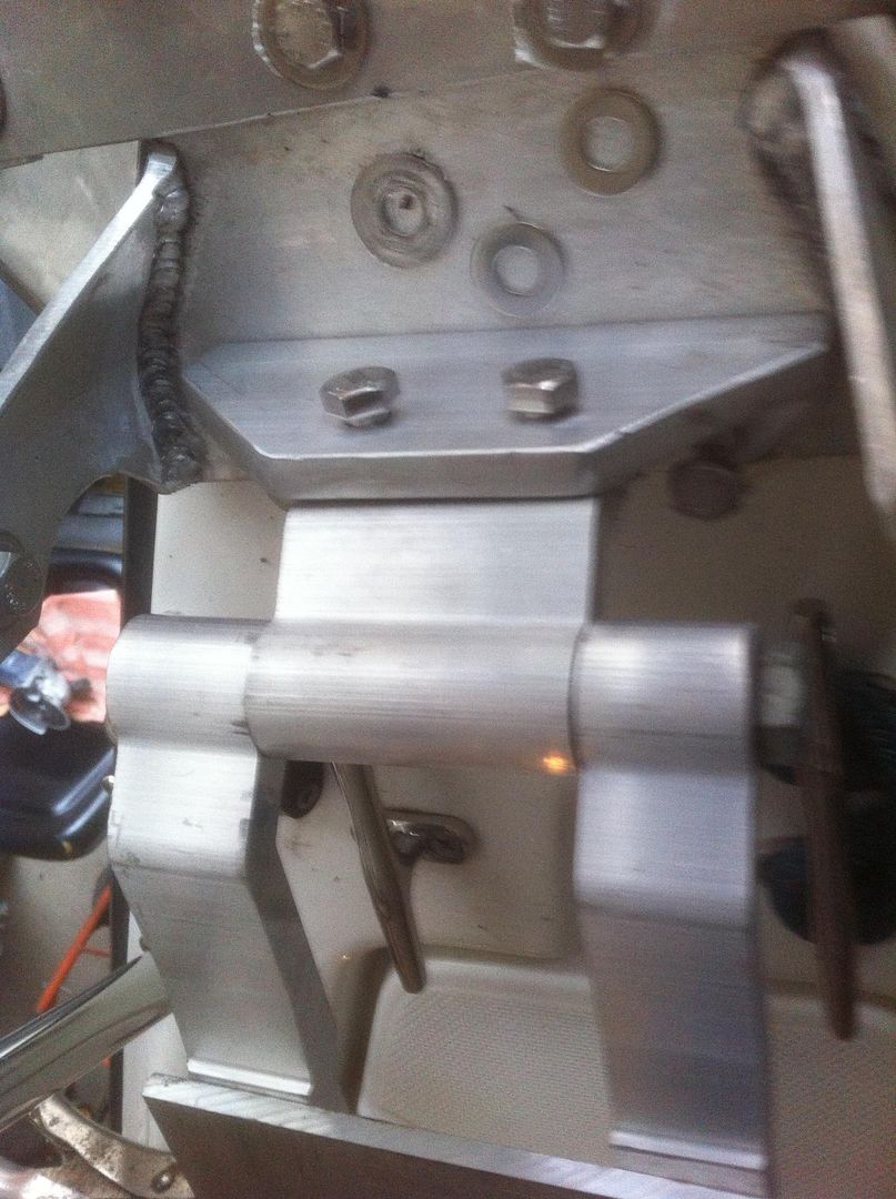

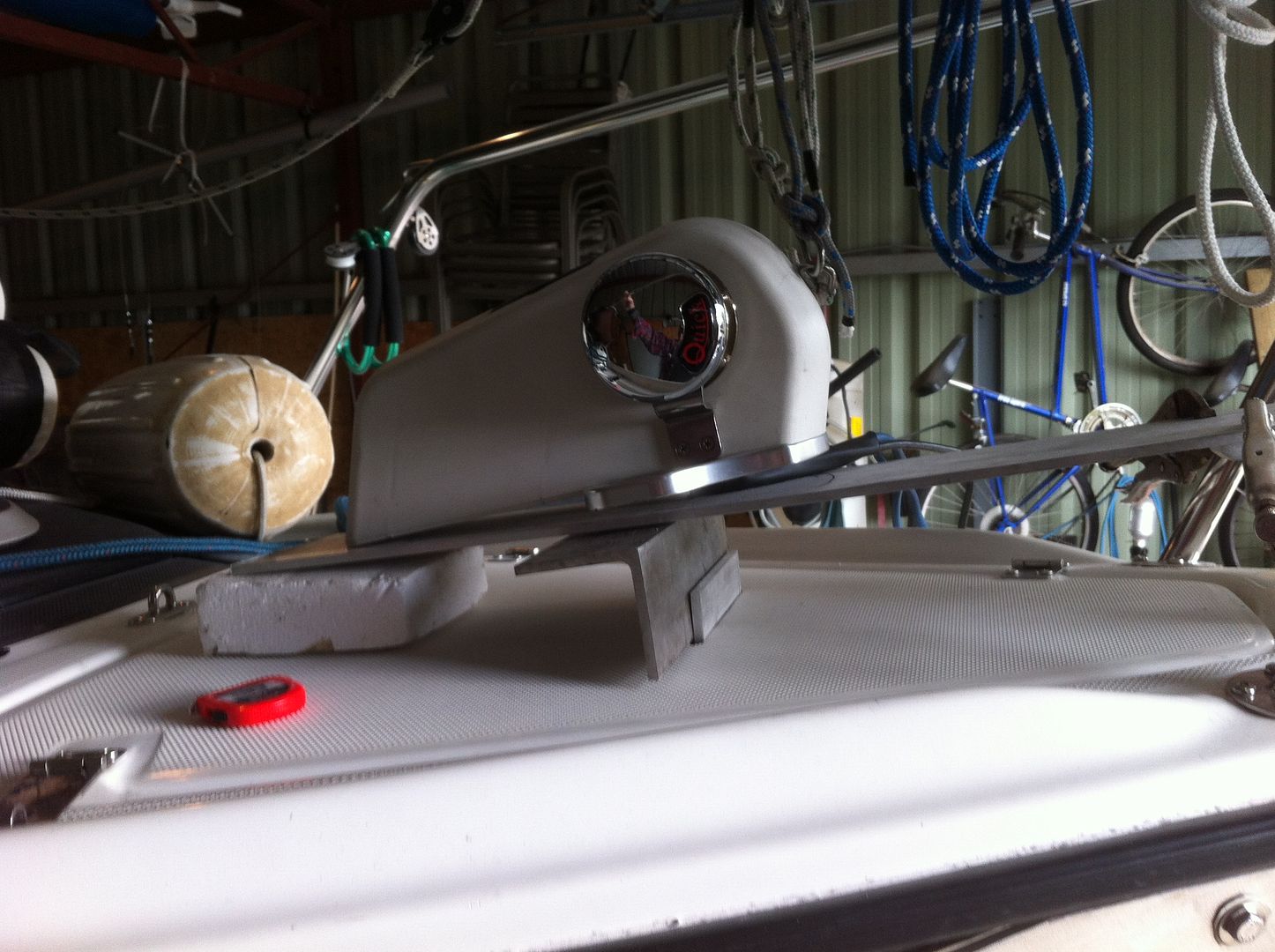

Well into the top swivel & base brkt's these r taking alot of time

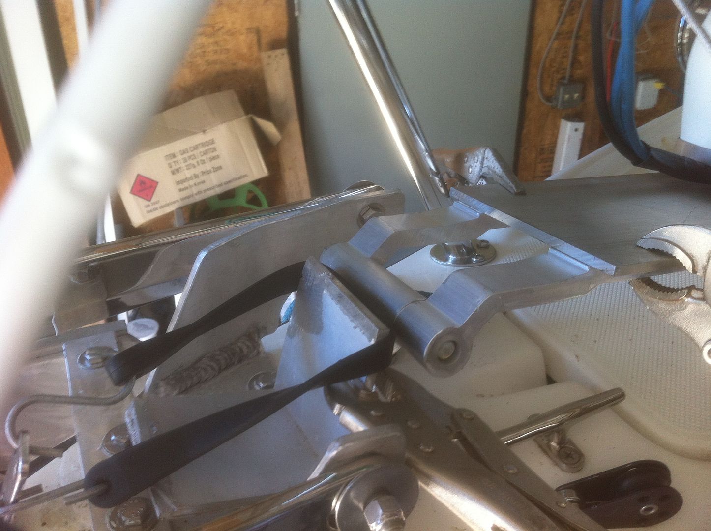

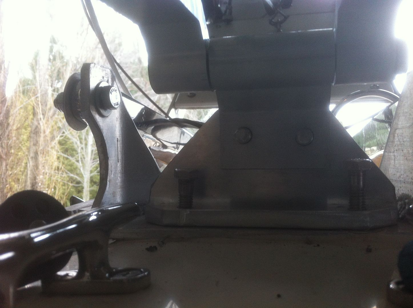

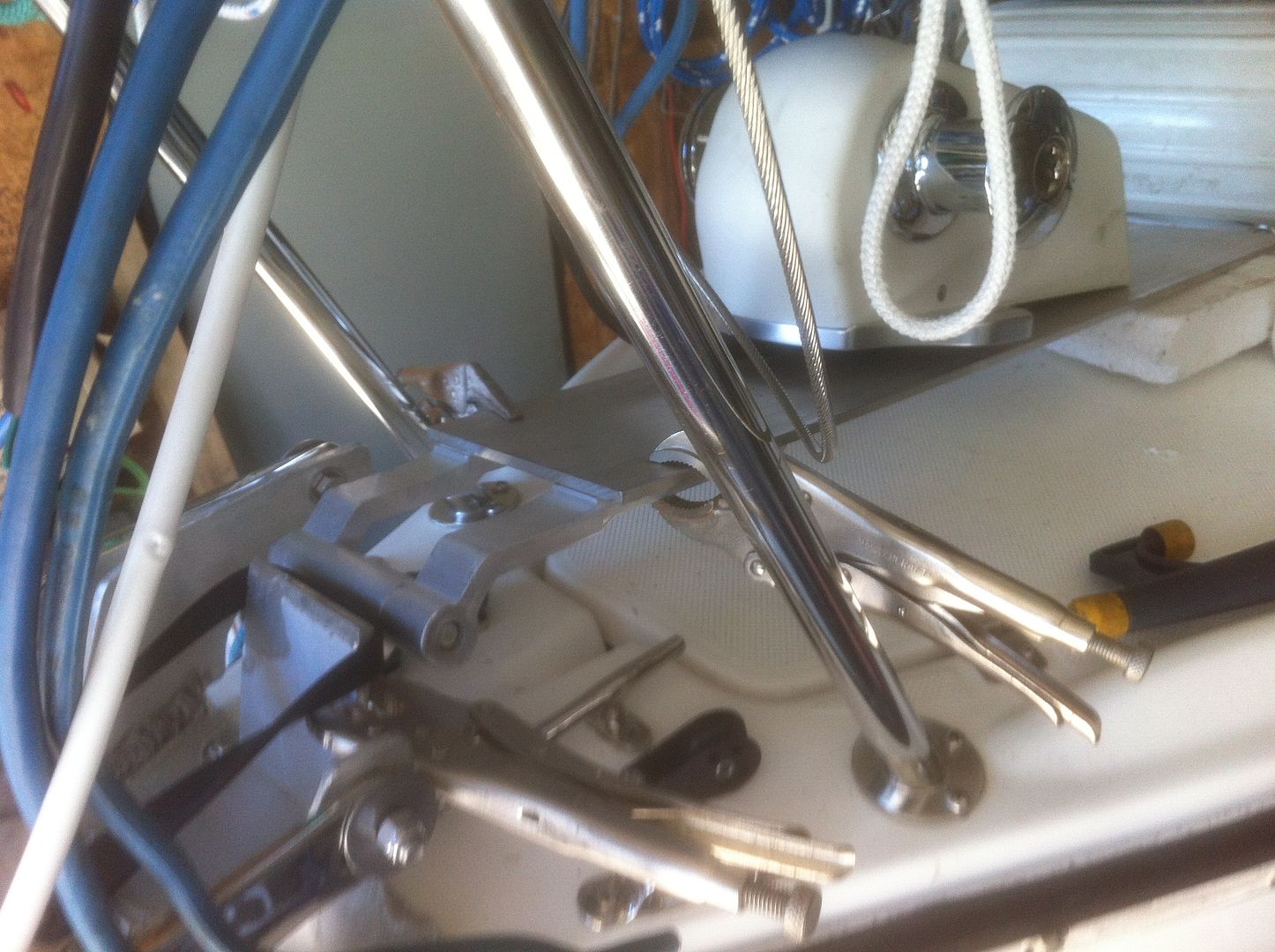

here's the top mounting brkt with the front hinges mounted with temp pre install fit
http://i844.photobucket.com/albums/ab1/ ... 2fc36b.jpg

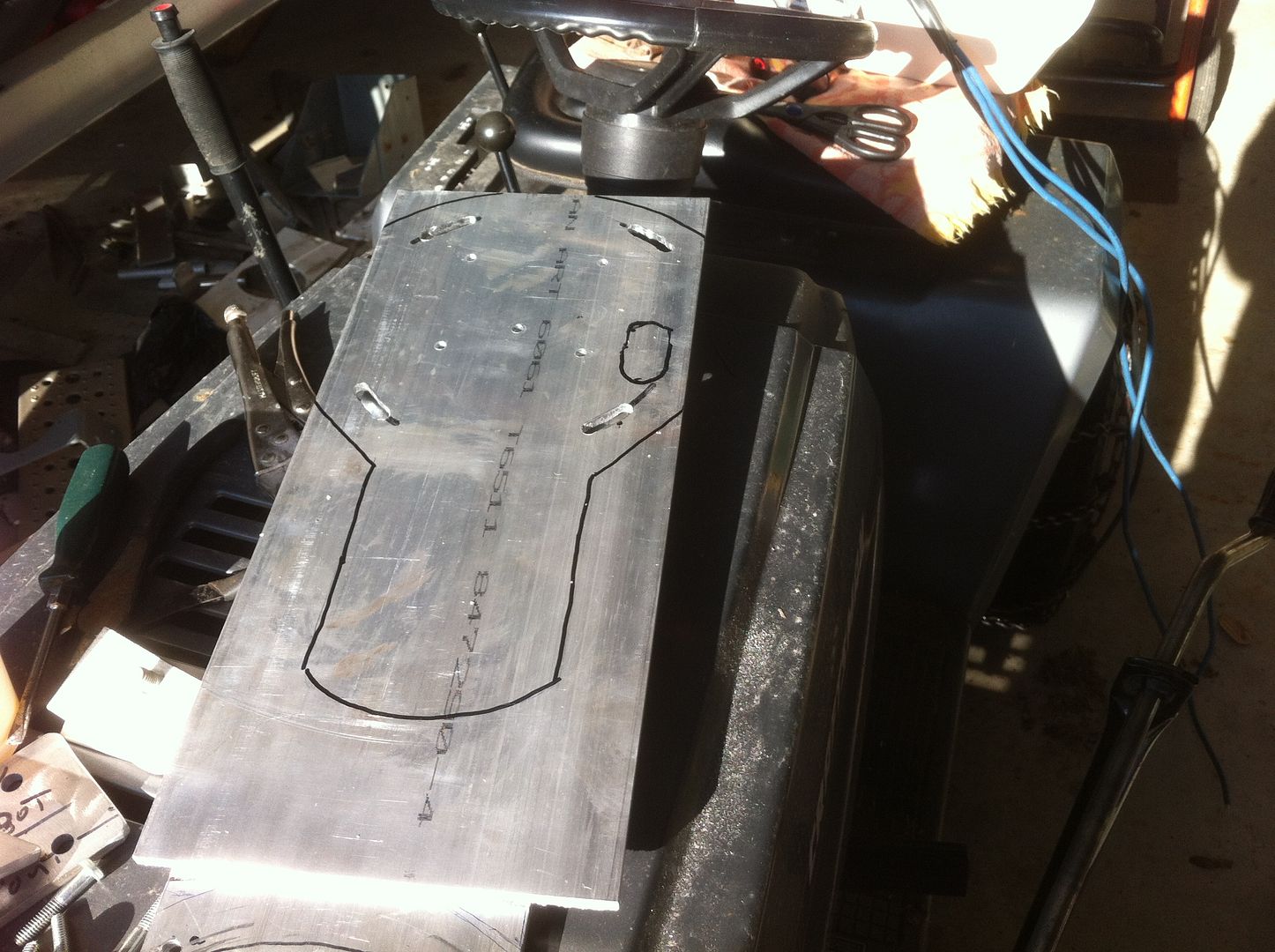

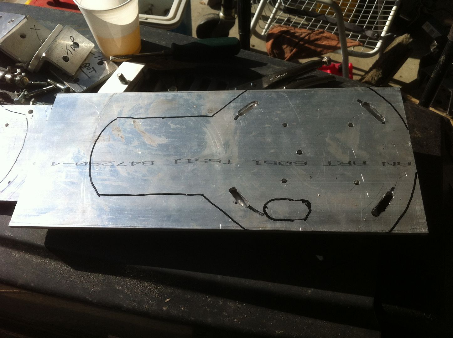

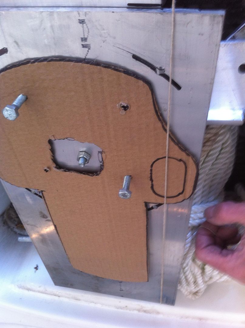

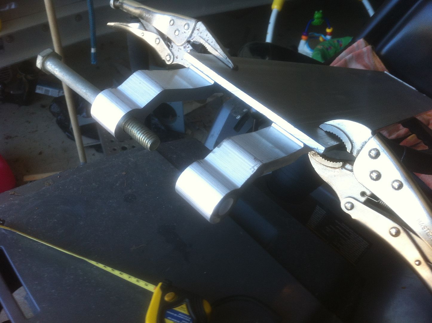

Here's the top swivel plate it had to have timed slots made into it so as it can turn from center to either port or starboard anchor rollers
http://i844.photobucket.com/albums/ab1/ ... 683195.jpg
http://i844.photobucket.com/albums/ab1/ ... f37963.jpg
http://i844.photobucket.com/albums/ab1/ ... edf281.jpg
http://i844.photobucket.com/albums/ab1/ ... dde694.jpg
http://i844.photobucket.com/albums/ab1/ ... 9af35d.jpg
