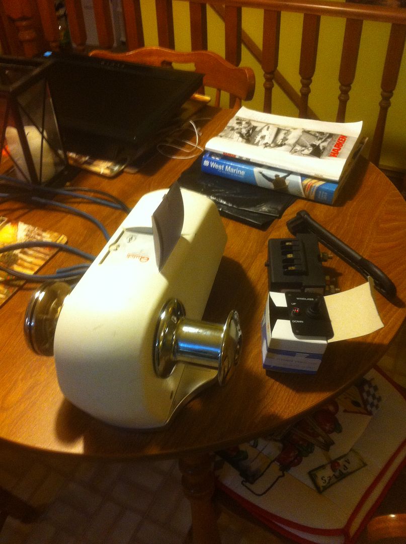

Well this will be another of my spring mods , got this for a song , a display model on clearance , they even through in the relay contactor & dash swicth & it came with a manual handle, chain gipsy is power up-down & free fall the capstan pulley can be opperated seperately or with gypsy , power is either from dash mounted switch or built in switches under top cover

Yer killing me here :D :D :D :D , Yes technically I am it will be mounted on a hinged brkt above the anchor locker lid so that will give it even more drop zone for anchor rode :wink: , the front hinge mount will be attached to my anchor retainer brkt which is already attached to the deck bow & hull with triple reinforcement = :idea: , the rear cross T- section of the brkt will be attached too reinforced brkt's coming from the already mounted rear bowsprit hull mounting brkt's this will be installed under the anchor locker lid , but above the anchor locker well inside it :idea: & already reinforced points @ the bowsprit aft mounting hull brkts will support this rear mounting brkt , . this set-up will let me unlock hinged windlass/capstan lift anchor hatch lid open , relock windlass in down poss. with just one 1/2" X 5" locking pin drop / retrieve anchor rode no need to be cutting anchor locker lid into two sections already drew up plans & modified them three times already :) trying to make it cosmetically pleasing to the eye & the boats isometrics has to look like it belongs their :arrow: :idea:

well here's a mock-up mounting brkt I'm designing the top plate hinge will be cut in half two make two 1-1/4" wide hinges & mounted on the top plate & the base hinge will go in between them this will be mounted onto my already re-inforced anchor base holding brkt shown here it is about 9" high off the deck this will be reduced 4 or 5" this will allow for an 11-12" rode drop into the anchor locker
