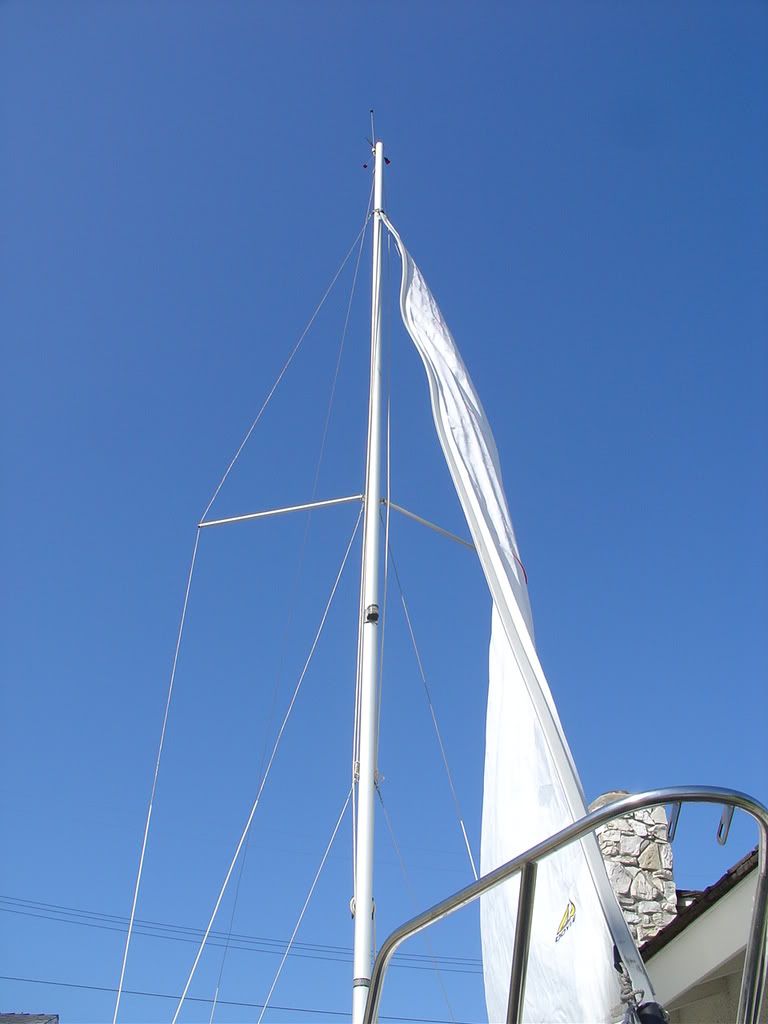

How would one get a curl out of their jib furler if one happend to have it?
:cry:
Posts: 1786
Re: Securing jib & furler for towing
Post by Kelly Hanson East »
Just leave it in and dont worry about it. You are more likely to damage it trying heat and craziness to straighten it and there wont be a tangible benefit to doing so with a boat like this.
Mine has a lot of "waves" in it. I've never suceeded in getting them out. I've used a hair dryer with no sucess. Some say to put it in a pipe in the sun for a while. I don't have a pipe that long so I didn't try.
Part of the problem was that I strapped the furled headsail to the mast and where the spreaders are and that bump deformed the furler extrusion. I now remove the spreaders which makes dealing with moving the mast fore and aft a lot easier. I use the mast raising pole to support the bottom end of the furler in front of the boat.

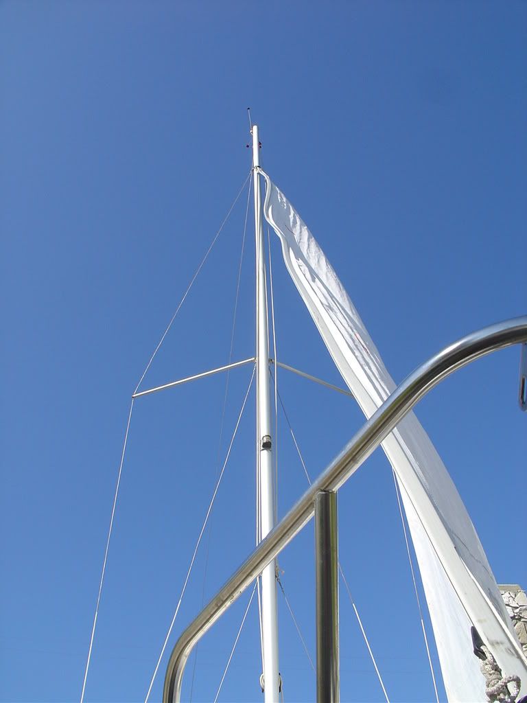

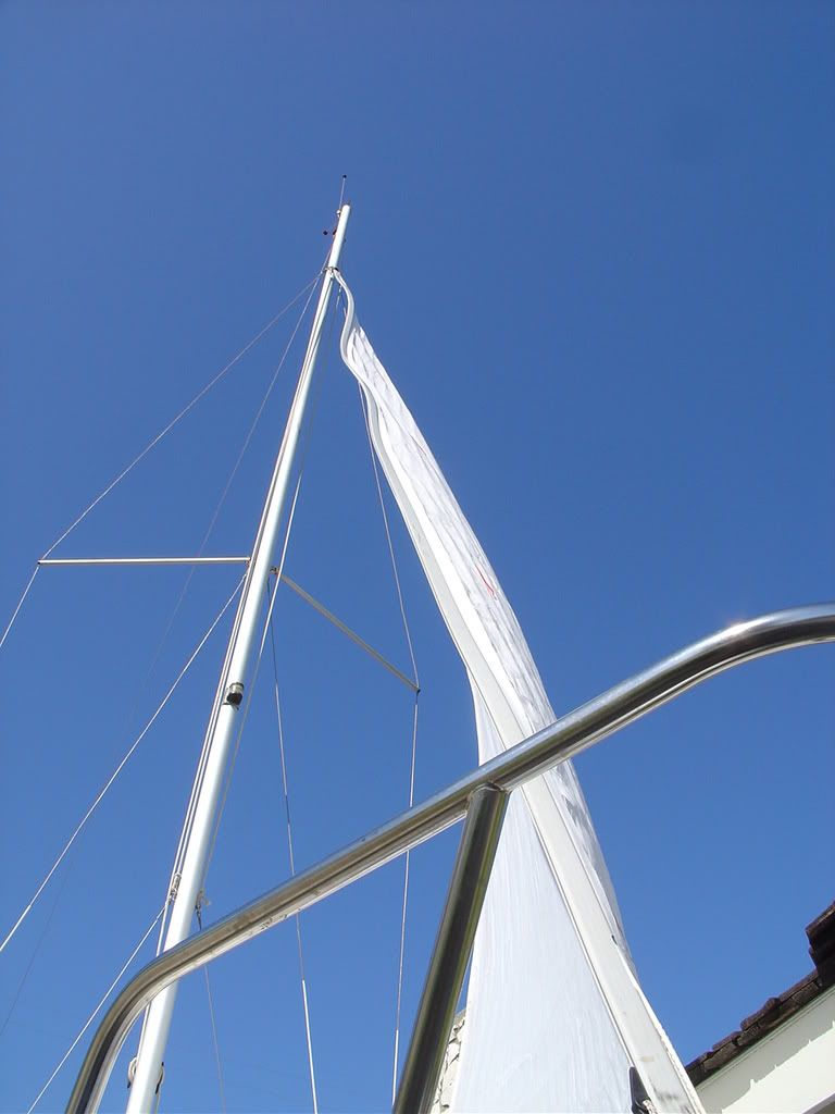

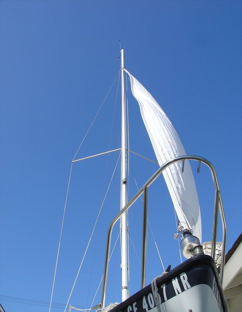

Post by Loala »
My problem is the PO before me stored the boat in the open hot desert with the entire extrusion laying on the deck but still connected to the mast while de-rigged. You can imagine the wild shape of it….
It’s not the worst thing in the world, just kinda unsightly. I’ve left it up on the mast to try to get the wave out with not much success.
I guess it’s just my anal ways….
http://s146.photobucket.com/albums/r254 ... Ron/Loala/
baldbaby2000
Posts: 1382
Post by baldbaby2000 »
Wow, that's much worse than mine. Maybe you should try putting it in a pipe in the hot sun for a while. I think the CDI manual describes the process. I took mine and laid it out on the ground with supports on the "low" spots and put weights on the "high' spots to level them out. It never got very hot in the mountains so I took a hairdryer to it too. It helped a little.
