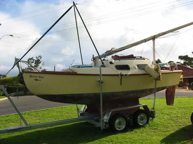

What about this for an idea... Instead of hinging the mast at deck level, build and fit a solid aluminium
"tabernacle" with the pivot point anything up to 2 feet above the deck. The mast has the pivot pin go through the side of it at the same distance from its base. As it lowers to the stern, the 'two foot' bit travels FORWARD out of the two upright arms of the tabernacle. when lowered and at deck level, the mast is now two feet higher along its whole length above the deck, giving more clearance.
To maintain the mast rotation, the actual tabernacle could be built to rotate on a single strong bearing.
Will it work? My old Vivacity had a solid tabernacle with the pivot point down low. When lowered, the mast was always at about 15 degrees. To get it lower and more level for transport, I had it modified by raising the two side arms and making another pivot point [ higher]. It works fine..but in this case, no rotation.
Note the different angles of the mast.
Puggsy
