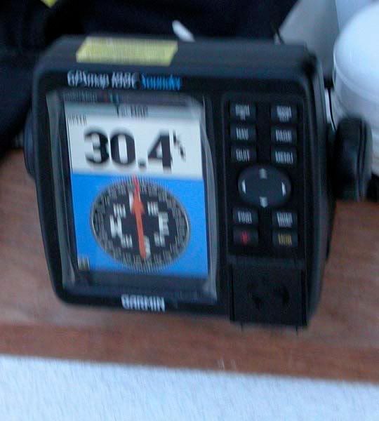

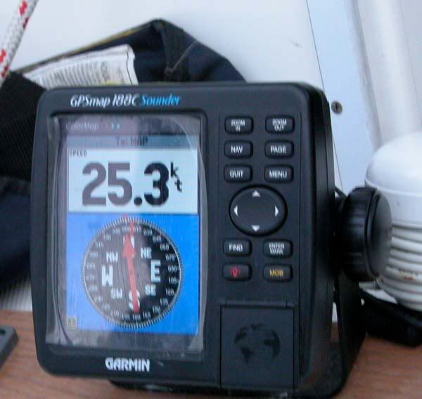

Here are 2 shots taken of the GPS last week on the Pamlico Sound by a Precision sailor on board. To say the least, I think he was impressed with the Mac. We had sailed across the sound and up South River. We only had about 1 hour of good daylight left to return to the dock. Of course we motored back, as evidenced . . .(note these are kts not mph).
Cruising at about 5000 rpms with mast up, generator, refrigerator, 10 gal. water, 20 gal. fuel, microwave, heater, food & clothes for 5 days, tools, 3 batteries, dive tank & gear, and lots of other junk including an Avon stored in the aft berth. When he commented on the speed, I just smiled and pushed the throttle to about 6300 rpm.
Was it worth installing an engine big enough? I'd do it all over again. Especially since the engine today can be bought for about $7,000 (+prop,etc.).
So go for it, Beene. You'll love it.
