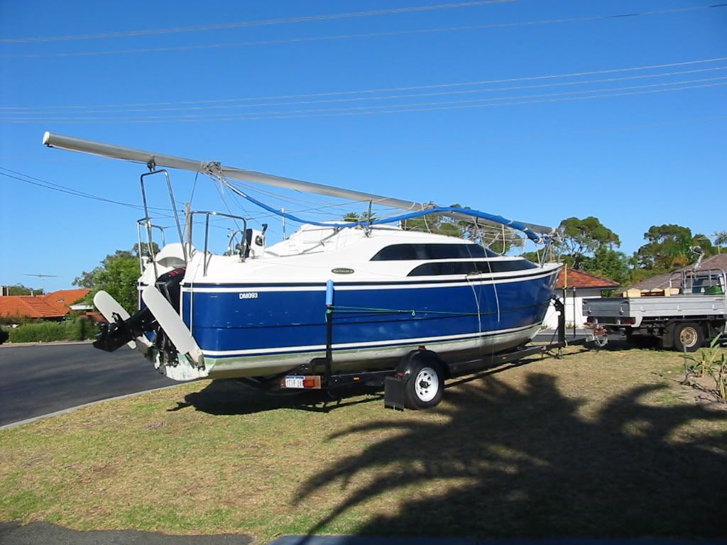

Re: Replacement Trailer Guide Ons
For SEAHORSE I have simply strung good cushioned [ with swimming pool spagetti] rope from the rear uprights straight to the "V". The bit it 'gives' in the rope allows the entry of the bow but prevents most of the sideways drift caused by wind or tide...and nothing ghets scratched. PUGGSY....
p.s. the pic was taken before the spag was added. there is a short bit on the rear upright.

I have a brand new
so was willing to spend a little bit more to replace the guideons especially as I often face cross wind or tidal streams while retrieving my boat. Had it done in Stainless steel and also use Pugsy's approach with a 12mm soft rope and swimming spaghetti type tubes. It works very well. My trailer is aluminium so kept the SS guides insulated by a thick coating of white silastic between all joints.
