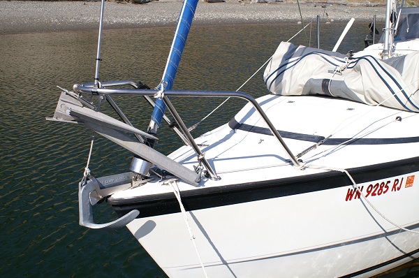

Your listed anchors are the exact same anchors I carry up here in the PNW. Just having a danforth style anchor (Fortress/Guardian) alone is not good enough, you also need something that works well in hard, rocky, and foul bottoms. We experienced a number of situations back in the days when we carried two danforth style hooks where we could not get either anchor to set. This has not been the case since we have two different style anchors that each have different strengths. The size doesn't matter if your anchor style is wrong for the bottom. Even a big danforth will not set in some of the bottom types common to the Pacific Northwest.
I also feel the G16 is the smallest anchor that is correct for our boats, even though it doesn't fit in the anchor locker. The G11 is too small to rely on overnight in a blow.
We have both our 16.5lb Claw, and our G16 on our bow, both fully hooked up to two rodes stored in our now divided locker and ready to be deployed as needed at any time. When you are drifting toward the rocks you don't want to be carrying your anchor up from below and hooking up the rode, they should be fully assembled and ready to go at a moments notice.

On other boats (like Duane's) I have see the loop that goes over the top by the roller but have not been able to locate one for the 26M's bow roller. That would be quite handy to keep the line in place when setting and retrieving the anchor. It also looks like Duane has also tied a line to the hole at the top of the claw and tied it off to the bow rail pulling it up against this "loop". That looks like a really good idea.

We use the Claw (Bruce) as the primary in Puget Sound. It's better suited for the most common bottom types from the Sound, north all the way to Alaska. Walk around the dock of any PNW marina and you will find the Bruce style anchor on well over 50% of the boats large and small. The Danforth style strengths are sand and mud. In general you will find very few sand bottoms in the PNW, and the mud bottoms you find will almost always be fouled with weed and shell. I taught diving up here for most of the 80's and can tell you first hand that there are no nice clean clear pristine bottoms in the PNW, every inch of every bottom is covered with sea life. Even when you find a soft bottom, chances are the hinge motion required for a Danforth to bite will get fouled and it will fail to set.
Both my anchors are secured on the bow with very easy to use quick release clips. The Claw is held in place with the pennant line from the pulpit. At the anchor end is a SS snap hook that goes in the hole in the anchor. It's quick to release yet keeps the anchor secure. Likewise I attached another SS snap hook to the pulpit leg with a SS hose clamp for the Guardian. It clips onto the anchor shackle and prevents the anchor from being lifted which is what is required to get it out of the bracket on the pulpit. These clips keep both secure on the water and on the road yet make it quick and easy to release the anchors when desired.
