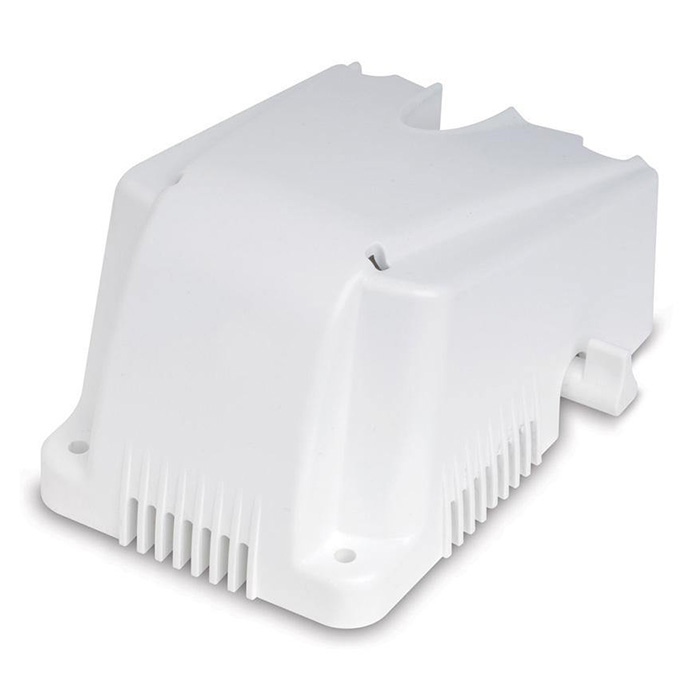

Couple of things about float switches. They are nice but will fail in one of many ways....come loose from mount, an item comes loose and blocks it from triggering, wire fell off, one of mine failed open circuit... You get the idea

The switches I'm getting....Catigale wrote:Sum
I wired in a total of four on myso that both the outer and lower bilges can be emptied
The two lower pumps are on ON-AUTO-OFF switches where AUTO switches the pumps through the float switches.
ON does two things ...direct 12VDC to the lower pumps and the stringer pumps which empty into the main bilge.
This solves the problem of having to put in multiple through hulls in too, of course
...have the cage over them and hopefully will be ok. The electrical switches will be as you described. I will end up with one more thru hull on the other side of the boat. They are above the rub rail, so they don't worry me too much and have valves in the discharge hose, although I don't think I really need those.
