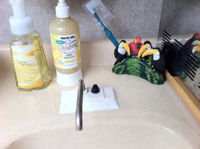

I finished installing my water system and have pumped many gallons of water and it works.
1. I installed the faucet to the galley counter as pictured earlier on.

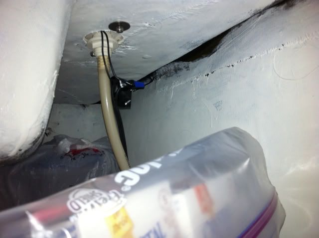

2. I installed electric pump with fuse to boats electric system as pictured earlier on
3. I installed a carbon filter on the water line immediately under the faucet and use water purifier in the water tank some kind of bleach liquid stuff.
4. I installed a manual primer bulb just under the filter

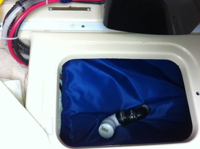

I purchased exactly the same faucet/switch and pump kit several years ago - and also used an electrical switch plate for mounting. Very simple install, and It works great. I did take a different approach to water supply, however, placing a 13 gallon Plastimo bag in the space under and to the rear of the galley. Since the Plastimo unit has its inlet on top and outlet underneath, no priming of the pump is needed if you place the pump under the bag - gravity takes care of it. This also keeps the weight of the water back where I want it, since with a full ballast tank our Mac tends to ride low at the bow in our slip. The faucet water supply hose and the switch wire are simply strapped to the drain hose [along with the wiring for our 1000w inverter], maintaining the ability to slide the galley, if desired.
