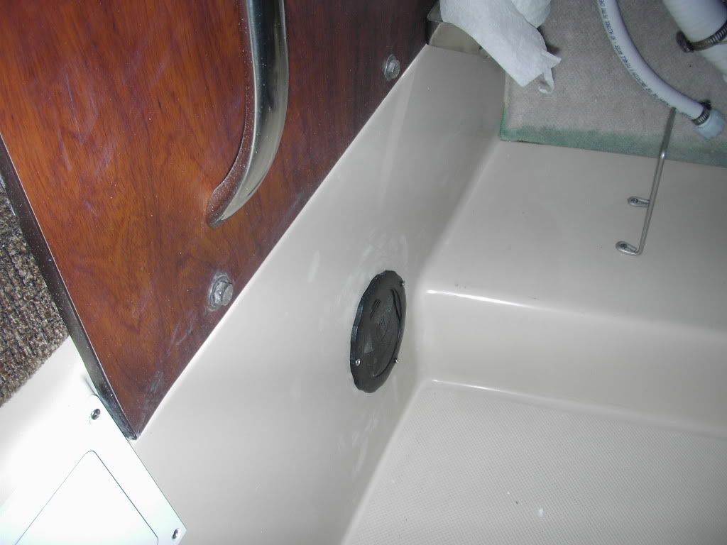

Well, I'll just say this about internal tanks. Many of you know I have one on my boat - 18 gallons in the center of the aft berth - and although I do have a blower, frankly, I've never had to use it because I don't get even so much as a whiff of fuel scent in that boat, EVER. And being it's actually *in* the cabin area (not below decks) you really ought to smell it if something's at all leaking. (And don't even try to counter with the old "yes, but gas fumes sink to the bottom so you won't smell them"... I've been around gasoline long enough to know that yes, they do sink, but the stuff still stinks to high heaven when it's leaking, regardless of where those fumes are sinking to.)
If you install it properly, secure it solidly so that it's all vibration-proof (including all the hoses), and inspect it regularly (to check for cracked hoses, etc.), there's nothing inherently wrong or unsafe about having a below-decks fuel tank. As I've said before when others on this board have been critical of my choice, I'll let you know as soon as it blows up... until then, I'm right.
BTW, it's at least 8 years and counting at this point.
I have a poly 18 gallon tank installed directly beneath the aft portion of the cockpit, in the center of the aft berth. There is an enclosure around it and it is vented to the outside air. You can see it in this picture:
Fill for the tank may be seen on the cockpit sole, just aft of the pedestal.
The gas tank is made of one piece molded cross linked polyethylene and meets or exceeds industry standards (ABYC, USCG, CE and ISO):
.. and it is secured to the aft berth's sole with a metal hold-down bracket kit made for the tank.

Exactly, Mike. This is why I placed my fill on the cockpit sole, as well as the tank enclosure vents - they vent directly over the back of the boat, with the fumes following the lowest path.aya16 wrote:I would Make sure the vent outside is completely away from spray or rain, a gas tank vent is usually in the back of the boat where there is very little chance of spray going up in it.
The vents can be seen in my cockpit photo... the fill (with integrated tank vent) is the black thing just behind the helm on the sole, while one of the enclosure vents is the silver thing in the helm station (look just below the bottom-most gauge - and that's my fuel gauge, BTW) while the other is back in the motor well (hidden by the motor's head in that picture).

Km I take it you used that fill/ vent cap you posted the pix of? Any way when your running the engine you wont have any smell as the vents sucking, when sailing
you don't have to deal with any sloshing as we do with the portable tanks..... ohh never mind I see the vent in the ped, high and dry, thats a good set up. Has any one tried a small electric fuel pump instead of the primer bulb to prime the engine? Most all leaks will come from the primer bulb, from the cheap clamps used to attach it to the hose......Your boat is way to clean...

Yes, Mike, I did use the fill I showed the pic (and link) for. It's a Perko and works nicely. You can even step on it and it won't open. And thanks for the complements on the setup.
