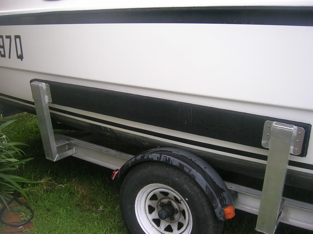

I launch on a ramp which is on an exposed point, has no dock, and most of the time, has some sort of cross wind or current! Some will say, put rope from the goal posts to the V block, but I have broke two goal posts and bent another badly. We have since put much stronger guides on the boat and my missus says this is "the best money we have spent on the boat!". Let me tell ya, when my missus spits out a sentence that includes "money spent on the boat" with a positive and happy look on her face, it is a very special thing indeed
These guide rails do not stick out past the wheels of the trailer like the posts, double as a decent ladder to the cockpit, and are very strong ( I have moved the trailer sideways on the ramp once when badly lined up.. ). Initially I was intending to keep the posts on as well but have found I dont need them. The rails make loading the boat SO much better. Having said that, in a high wind, its obviously still a pain to line up. What | do then, is only put the trailer half way in the water, and walk it from the beach to the ramp and inbetween the guides. I then back the trailer all the way in.
Loading is just so much easier since I got these things, but if its REAL windy out there, I must admit, I still just leave the boat at anchor until the wind dies - the benifits of living 200 yards from the ramp

Paul,
Where did you get the guide rails or were they custom made? How expensive were they?
They sure look like they would be a great addition to our trailers.
Aaron
Aaron

Hi Aaron
I was having a new draw bar welded up at the metal fabrication place at my local marina and told them of my breaking goal posts problem. He said they could fix that easily and I said do it! From memory I payed about 600 bucks which included the drawbar, but we pay about double for stuff like this here so I imagine a similar bill over there would have been 3 or 4 hundred. For just the guides to be fabricated (not the new drawbar part of the bill), I doubt you would pay more than a coupla hundred there.
You just need go to any metal fabrication, or boat trailer place, and they could copy photos of my setup. I'm happy to take more photos from different angles or whatever if anyone wants them. I use this as a slightly awkward ladder to get in the cockpit. It would be easy to add a coupla steps to it to make a very useful ladder out of it.
If you retrieve from a no dock ramp, I assure you, you will find this a MASSIVE improvement
