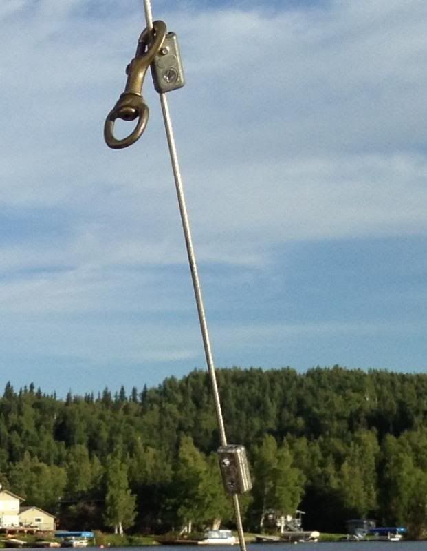

I am afraid I already know the answer on this one but I wanted to check with those that can tell me for sure. In the following pic you can see the backstay over my head. Look carefully and you can see two mechanical connectors. It looks like the backstay broke and someone used the connectors to splice in a 3rd piece and repair. The snaps for holding the boom up are hanging on the higher one.
I plan to replace this unless you all tell me this is as it should be. But, my hope was that we could finish the season (short time left here in Alaska for sure) and fix it with everything else we plan to do up high when the mast comes home for winter.

When blowing up your image (it's pretty low rez), it appears that the crimps are just over a continuous wire. I would expect that the wires would be offset if it were a splice. Of course, with the poor quality picture and due to the perspective of the camera, I could be mistaken.

Good point on the low res image. Why would there be inline fittings such as this? Just to hang the boom?

Looks like simple clamp-ons to allow flying a flag from the backstay. Also, it allows for a handy place to clip the boom lift hook.

Or a back sail while at anchor, to avoid much swinging around

Good to hear for sure. I was imagining a splice and that got me worrying.

I was thinking 2 locations for hanging the boom. Maybe the higher one for getting it way up out of the cockpit for entertaining and a lower one for leaving the boat so the boom is more level. Either way, it's not a splice.
My Hunter 30 had a crimped on 6" piece of cable and clip attached to the backstay to keep it from flopping around even though it had a real backstay.
