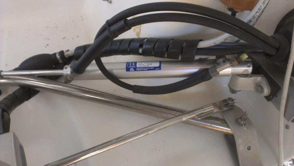

Sorry Andy, wasn't sure exactly what you were looking for. I have Telefex's Seastar hydraulic system installed on Chameleon linking the rudders and motor together. As I said, I love the system. It does remove a lot of steering effort that was felt before with the original system but seems to still have a decent "feel" for whats occurring while sailing. Now with that in mind, I do come from a powerboating background and Chameleon is our first sailboat but I do find the hydraulics much more comfortable.

Alright thanks to all for your help, support, and examples. I finally have my baystar installed. Let me post a shopping list of stuff to make the next persons life a little easier.
0. eye protection, head mounted flash light, qty 2 7/16 open end wrench, qty 2 9/16 open end wrench , 5/8 , 2 cresent wrenches just in case, copper anti seize compound, and a 7/16 socket wrench (not deep socket) with a universal joint if you have one. Impact driver with a #2 phillers driver extended bit , some go joo, lots of rags, and definitly some gloves . You will need to bring a friend to help bleed the system.
1. 18 piece hole saw kit from harbor freight. Use the combination of 2 hole saws that comes with this kit to cut the 3" hole. The inner hole saw will align to the existing hole and the 3" will cut the needed size for the baystar. Makes a perfect cut this way.
2. 3" hole saw from home depot in case the harbor freight hole saw fails and starts to burn the wood instead of cutting it.
3. 5/16" drill bit. drill the initial hole with a smaller drill bit as a guide for the bigger one (for the bay star steering unit)
3/8" drill bit for the 3 holes to mount the hydraulic actuator
4. from midwest controls
STM-6 Spherical Rod End, Male, Stainless, Teflon Race 3/8 qty 1
STML-6 Spherical Rod End, Male, Stainless, Teflon Race 3/8 qty 1
AHT6-12.00 urnbuckle, Hex Bar, Aluminum, 3/8-24 12" qty 1
3/8 x 24 RH jam nut stainless from bolts depot
3/8 x 24 Left HAND jam nut stainless
3/8 x 24 Scotty Bolts qty 2
5. from bolts depot
3/8 x 24 2.25" bolts stainless qty 3
3/8 x 24 2.5" bolts stainless qty 3 incase the above is too small
6. extra thick fender washer 3/8 x 1 1/2" stainless. I'm not sure how many you need but you need a bunch of these. inside the boat near the stern around where the transom area you will need to mount the bay star right in the center (its very close to where the bolt used to hold the cable steering is located). There is basically a piece of decrative fiber glass covering the outer fiber glass in the outboard motor bay. You could cut this entire fiberglass out OR you can drill a 1.5" hole and stack bunch of fender washers such that with enough washers you clear the fiberglass and your boat stays nice and pretty. I have a lath so I just fabbed up some really large spacers.
7. dremel with cut off wheel .. trust me when you need this you'll know what to do with it. Basically I use it to cut the bolts to size because they will get in the way of the bleeders.
8. 3M marine adhesive 3200
The only real issue you guys will have is, how the heck are you going to mount the Spherical Rod End to the bay star.. The bay star is metric and uses a 11 x 1.25 thread (I actually forgot but its a weird size.. maybe someone else can confirm.) I think its 11 x 1.25 or 11 x 0.75 but its a fine pitch for this large bolt. One thing you can do is use an aluminum or steel L bracket. I had some Unirac L brackets at home so I used that. If you look on ebay you will find them cheap, like $30. Unirac solar serrated L foot. You will have to cut open the hole on the inside to 11.5mm and 3/8 on the other side. You will also have to cut some of the material to so you don't hit the bleeder on the bay star. This bracket and control rode is installed on the starboard side of the boat. I didn't use any control linkages on the port side.
Overall the system took only 5 hrs to install , 1.5 hrs of machining time at home for the bracket and spacers. I'm very pleased with the system. Removing the existing steering wheel was easy enough with a 3 jaw gear puller. Make sure to use copper anti seize compound on all nuts and the woodruff key inside the steering wheel. I also used the same compound on the mating surface of the steering wheel also. the 3M sealant should be used on the bolt and fender washer entering the hole you drilled in the transom area to prevent water entry.
