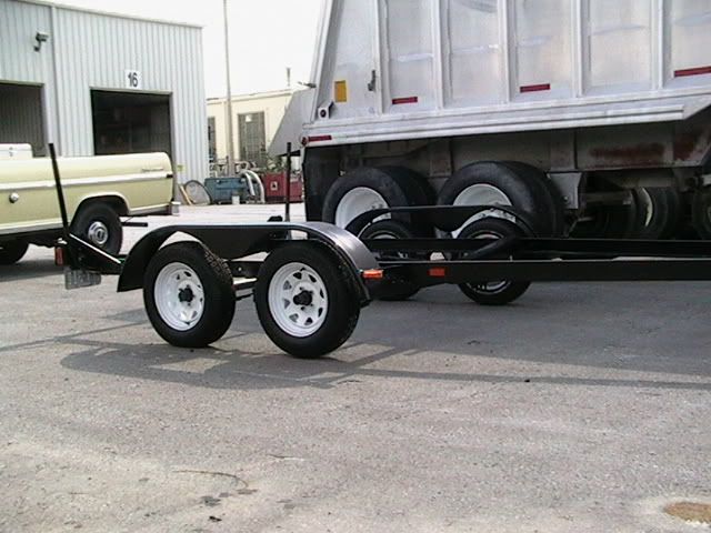

Here it is, the factory Mac trailer upgrade
I pulled the original tires as they were an odd size and hard to find. I opted for lower profiles to lower the center of gravity.

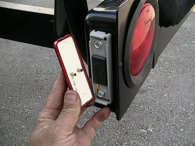

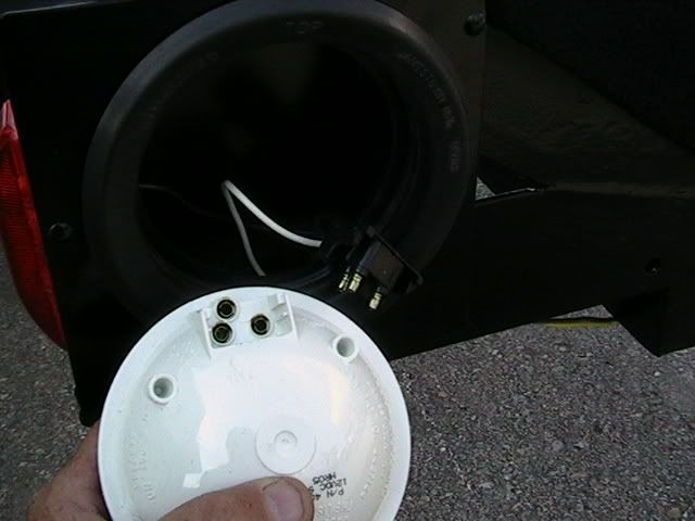

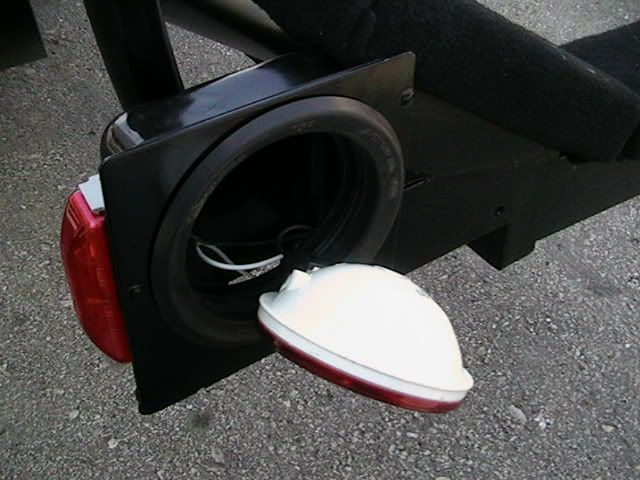

Tractor trailer light unit, cut in half with the open side down. Will drain when pulled from water.
Sealed commercial 3" light
Quick disconnect
Side Markers are also sealed commercial units with quick disconnects.
I just left the brake lines where they were and slid the axle forward. If you look close enough you can see the slag from the original spring hangers.
All thats left is screwing with the stacks to even out the axle weights.
