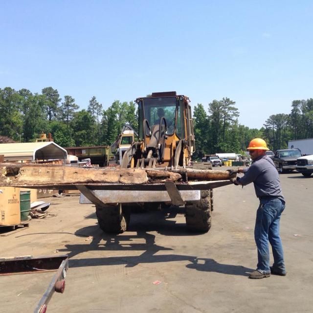

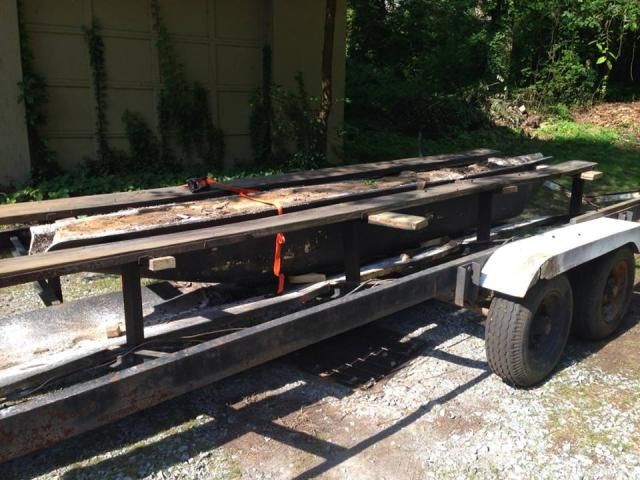

I took this to the scrapyard
and got over $500 for it
Took the trailer back home and painted it up nice, and selling it for around $700

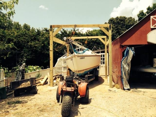

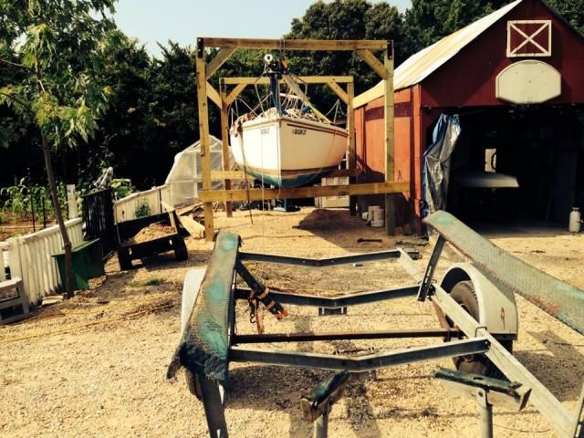

Got the Boat hoist completed... Now Can lift sailboats off trailers up to 3000lbs
Now Bottom work, trailer work, and keel work just got so much easier
Camera angle makes her look a little crooked, but trust me the lift is stout! That is a Catalina Capri Wing Keel up in the air...weighs in around 2400lbs
Cheers Mates!

81venture wrote:Got the Boat hoist completed... Now Can lift sailboats off trailers up to 3000lbs
Camera angle makes her look a little crooked, but trust me the lift is stout! That is a Catalina Capri Wing Keel up in the air...weighs in around 2400lbsi
Cheers Mates!

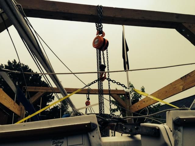

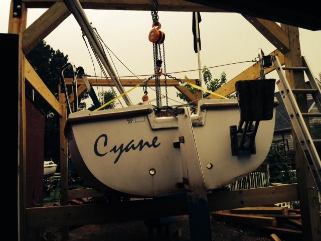

what size timbers did you use? Also what did you hook to the chain hoists to lift the hull? Inquiring minds want to know
81venture
Posts: 553
Location: Wake Forest, NC
Post by 81venture »
We used 6x6 that are 4ft in the ground and 11ft high ...3 80lb bags of concrete each one
the top pieces are connected by brackets I made from steel...puts the weight straight down
2 two ton chain hoists, one on each end....with 6000lb capacity straps slinging the boat bottom
We hoisted her up like it wasn't even there we were actually standing on the boat while we hoisted which was pretty neat
After hoisting we put the boards under her and "pinned" them in. they are for safety and the boat is then lowered slightly so about 50% weight is on the cross beam and 50% still on the chains...so she doesn't swing
it works like a charm....

RussMT wrote:Nice job. It's about time you got a real lift for your marina.
It's hard to see in the photo, how did you hoist the boat? Are their straps/slings?
There is a 2 ton chain hoist at each end.....then the boat is slung in 6000lb straps underneath and hooked to the chain hoist.....
it goes up easy as pie...after she is up and swinging the boards are "pinned" in underneath and she goes back down so there is roughly 50% weight on the bottom cross support and 50% on the sling/chain.....is very stable!
Keel Work, bottom paint, etc just got a WHOLE lot easier 8)
dave
Posts: 8343
I see the straps clearly in those photos. Nice job. I'm certain it is a whole lot easier now.
