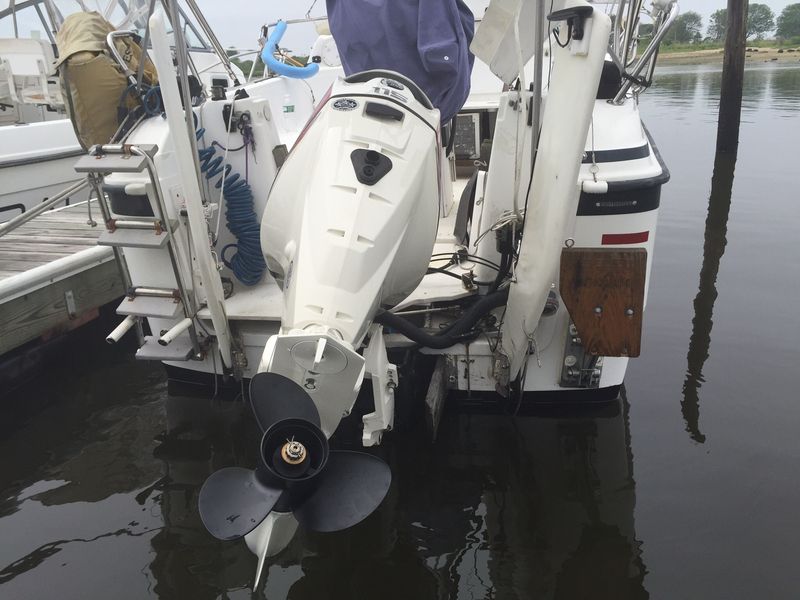

On my transom is a new 115HP V4 Pontoon Series E-tec
I also paid for a: Sand blasting, SeaHawk Tough Stuff Barrier coating x2, 1 Cukote Harder Ablative (blue), & a Micron hard(er) black ablative coat
I just went for a boilerplate test drive. Where I didn't feel comfortable & there wasn't enough room to truly open her up. But I'm happy
HOW happy will be posted next upon taking her to my homeport where I can really open her up. I hope to take her home tomorrow - But won't be able to put her in her home Port of Bayside Marina till Sunday. Gotta Work. While I'm retired FDNY, I'm also a frustrated musician booked EVERY weekend singing Jimmy Buffet stuff like - "Oh how nice it is to be on the water in Paradise" till Late Sept
Next week, or so, I'll give the full story
I don"t expect a monumental difference. I'm currently propped with an aluminum 15x15x3 V6, 15 spline prop. I think we can do better but time will tell. The factory was happy - but they've never seen a [Powersailor] sailboat Plane. So ... We'll see - but the V4 was as far as they were willing to take me - & a$ far a$ I could afford to go
$o Therefore, I Am Happy
