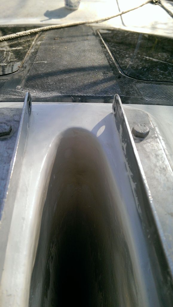

Here is the repair with the first coat of gelcoat (that did not set up last night
) Note that there is no longer any deck overhang into the trunk - all is supported by brass reinforced epoxy.
I consider this a repair of the damage, not sure if it solves the problem.

Looks like it never happened! I'd be doing Ix's mod as well for extra security as well.

I was just thinking about drilling a hole each side in the top behind the forward foot. Use this to hold fender washers with a bolt. Fender washers would protrude far enough to rest on the mast base deck brackets. Washers would allow adjusting the thickness and even using a brass one at the bottom to avoid damaging the edge of the steel angle since such a loading here has the chance of deforming these brackets (not the normal way to load such a member). Washers are also easily repairable and offer more of a bearing surface than a pin. Plus avoids the challenge of drilling through a fillet weld.

Anyway, just wondering if any of you came up with a solution that you're happy with.. We have the same type issue. The PO istalled 1/8" ss plates under the mast base angles, covering the daggerboard trunk and drilled another set of holes in the angles (not sure why) in the middle and thru bolted it all. We had to take the whole thing apart to get the daggerboard out to inspect (and subsequently rebuild). We fixed the top of the trunk and thought we might just install the angles without the plates but the mast base doesn't look right- i'm pretty certain that's why they installed the plates. Some of you had said that the 1/8" plate would adversely affect the rake and we would like to be able to pull the daggerboard without taking it all apart. So, we're just wondering if someone came up with a better plan?
i have to say, we haven't had her out on the water yet, so I don't know if we had the rigging properly adjusted whether the base plate would damge the trunk, but it appears that the PO did, so we're trying to fix a possible issue before it comes up.
