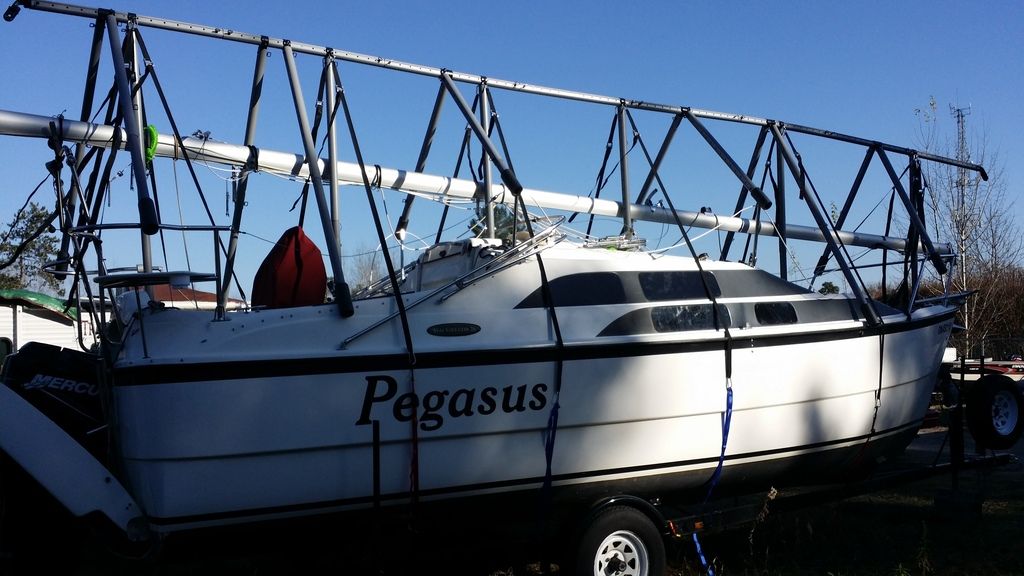

Re: winter cover for 26M
Just for a point of reference, I put a 2x3 on the flat across the two lifeline stanchions on the cabin (with partial depth bores to capture the stanchions), and another on the mast, plus a short support under mast at the tabernacle, and build a rib cage across all that, with four ribs on each side. Slacken the lifelines, and tarp with cheap black/silver Harbor Freight tarps. Most snow doesn't remain, but if it piles up, I snow rake it off. Tarps have survived five or six winters so far. Line to tie the tarps to the trailer are long Home Depot hanks of some cheap braid.
Ends of the ribs are match marked to the rib on the mast and on the stanchions (port and starboard, 1-4) so it's quick to put it back together in the early winter. Yeah, I wait until November. Often late November, which is really pushing my luck around these parts. We get around 100" [2.54 m] annually, on average.

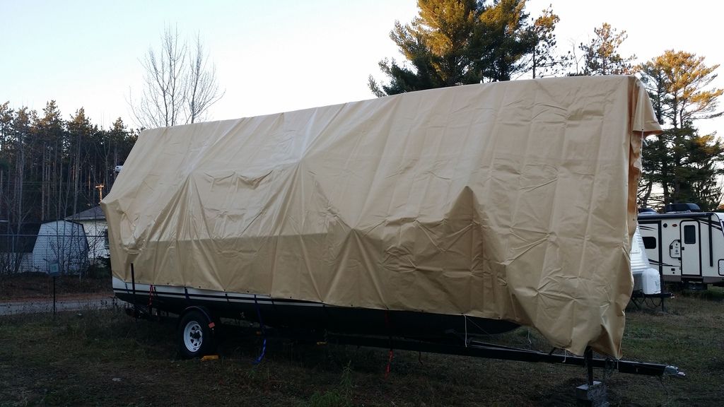

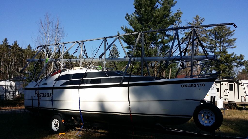

I use a custom tarp from
Tumacs covers. From http://thesailwarehouse.com/cgi-bin/web ... anvas.html
We moved our
from AB with lots of winter wind which kept the tarp clear of snow to NW Ontario with lots of snow.
To address the sag points between the stanchions and horizontals mast I inflated exercise balls in 4 points under the tarp. Hoping this works as we are 20h away.
Hugh
