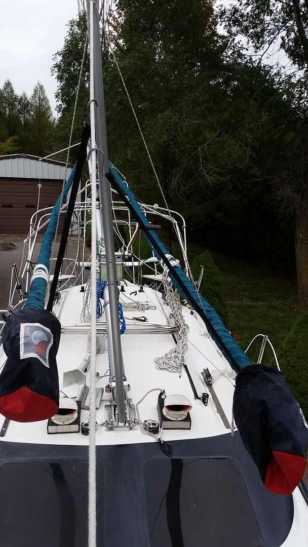

here,s a pic of my mast base brkt as u can see there is very little if any taper to the footbase i will try to find a frontal view later & post it
if u save this pic to ur computer u can blow it up to get a bigger view

Highlander wrote:here,s a pic of my mast base brkt as u can see there is very little if any taper to the footbase i will try to find a frontal view later & post it
Thanks! I can see it clearly on my computer - it looks the same as mine. :)

If you compare the mounting position of your angles, it appears they are bolted 3/4" aft of where mine are - based on the front corner where the cabin top rolls up to the mast base platform. Your camera angle may be fooling me, but that appears to be one issue. If the "B" team installed your mast base hardware aft of the design location, that would produce the problem. You may want to consider moving the base hardware. If you decide to move it and need accurate measurements, I can go downstairs and get them for you. Just tell me what dimension you want. Good luck.
