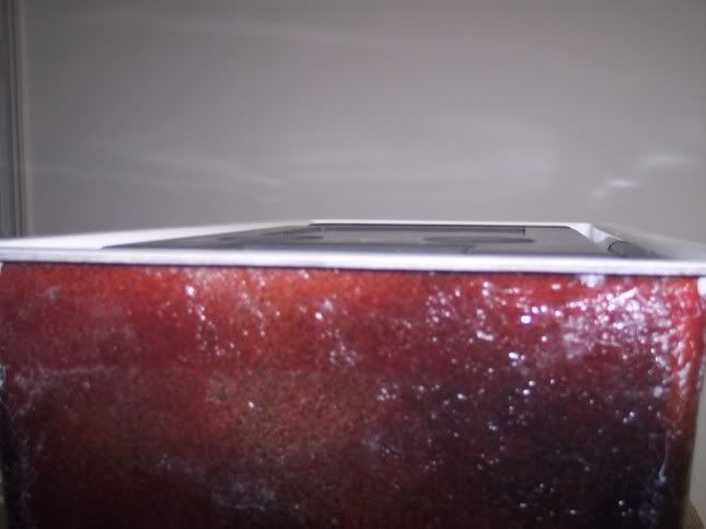

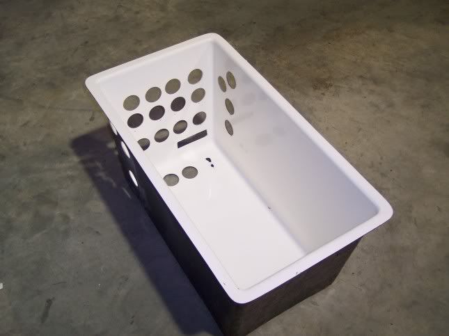

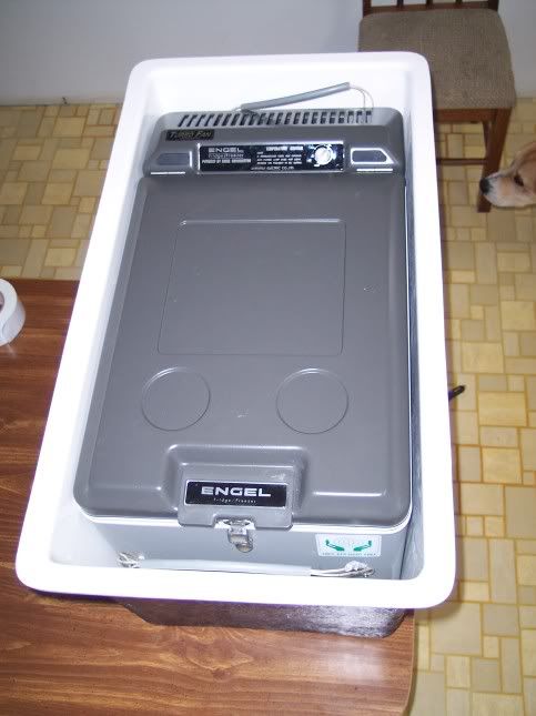

The MacGregor supplied Coleman 48 quart cooler that fits in the cooler tub is specified as 14.88" x 25.5" x 13.5". I'm not sure which of those dimensions is height and width.
The Igloo Max Cold 70 quart cooler Frank C used without the tub (but on top of a 3/4" thick board IIRC) is specified at 29.5"L x 16.31"W x 15.69, but he did have to trim the width of the seat opening about 3/8" on each side, IIRC.
The outside dimensions of the Engel 35 (34 qt equivalent) chest refrigerator is spec'ed at 25.5" x 14.3" x 16".
I can't find it now, but I THINK that at one time I saw one of these mounted in the 26X ice chest tub, which was cut out for ventilation for the refrigerator's fan, etc. Maybe not, but it should fit in place of the tub.
I think we've determined these should use about 17-20 amp-hours of 12VDC every 24 hours when not on shorepower. And keep in mind you need half or less the volume since you don't have to have ice in it.
If I needed a refrigerator in a 26X, I think this is the way I'd try to go.

If you don't mind spending to extra money, the Engel 35 is the way to go. Especially if you're dealing with 90+ degree weather. It will fit in the cooler bin, but I needed to remove the foot pads and handles. (Made some wire handles.) Never notice any additional heat in boat, the unit is quiet, and power draw is minimal. Here you can see the clearances. I just drilled a few holes in the bin for air circulation. Has been really great for long trips.
