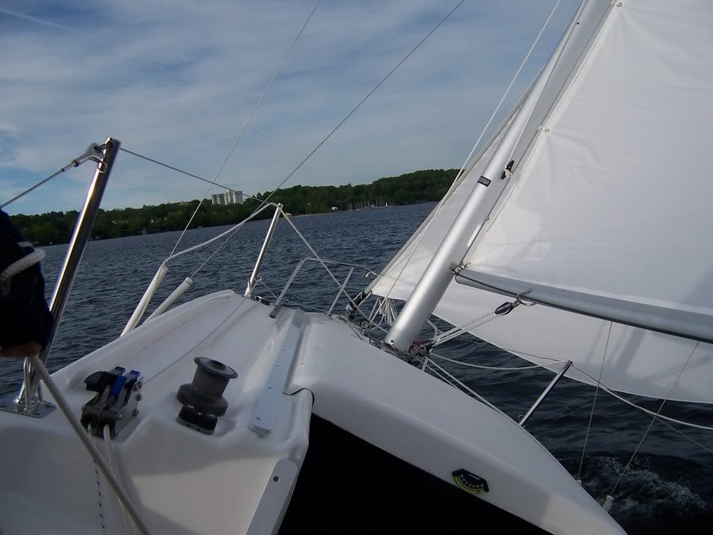

The winches on the 26X and 26M are sheet winches, not halyard winches.Duane Dunn, Allegro wrote:Another thing I see regarding Beene's halyard clutch location is it puts the lines right in the center of the area you need to step on when going forward. I would think forward of the winch allowing the use of the winch for tensioning the halyard and more inboard would get the lines out of the way better. It's real easy to roll an ankle when stepping on a line like that.
