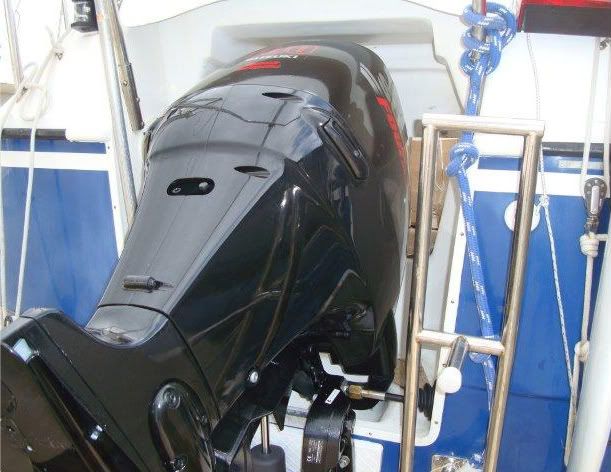

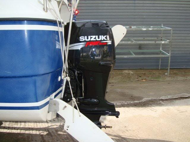

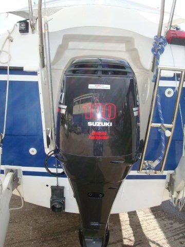

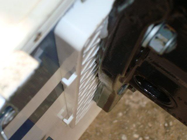

Okay, so, here we are; it's raining, it's cold outside and worst of all, the propeller hasn't arrived yet.
So, while we wait, I uploaded a few more photos for those interested.
Here's the wedge that went in,
and you can see how the Suzuki DF100 lifs up without touching the 'raised' helm seat.
The 'raised' helmseat was a mod performed for the 70 I had previously that fortunately requires no modification at all as the new engine, even though slightly larger in external dimensions, fits beautifully under the 'raised' seat and swings freely up and down.
You can also see how the steering cable comes out of the starboard side and connects to the engine. Also a mod of the past.
Have a great weekend!
Octaman 8)
Re: Re-powering a MacM from 70 HP up
Sweeeeeeeeeeeeeeeeeeeeeeeeeeeeeeeeeeeeeeeeeeeeeeet!!!!!!!!!!!!!!!!!!!!!!!!!!!!!!1
I like it
Very clean
Love the steering cable vs the stock one
Love that seat mod. Don't think it would be tall enough for my 75 though. And Highlander's is even taller than mine. The 150 we looked at was a 2 stroke and had a shorter head.

Ah Yes very nice indeed the plastic wedge kit will be better than the alum one in salt water never new they were avail when I installed mine ! where did you get then !

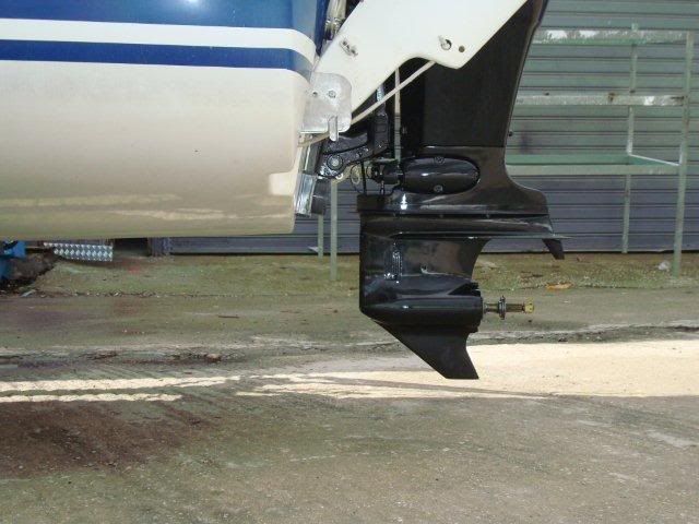

Is the cavitation plate even with the bottom?
Did you add a backing plate on the top bolts?
Octaman
Posts: 198
Joined: Tue Jul 06, 2004 12:24 pm
Location: Athens, Greece, 26M/2004, Suzuki 100HP/2011
Post by Octaman »
vkmaynard wrote:Is the cavitation plate even with the bottom?
Victor, these photos are for you . . .
I have always had a backing plate on the top bolts, also with the 70. Kept the same one with the 100. Don't have a photo of it, sorry.
Highlander,
the plastic wedge is available locally in the marine market here in my part of the world.
Octaman 8)
