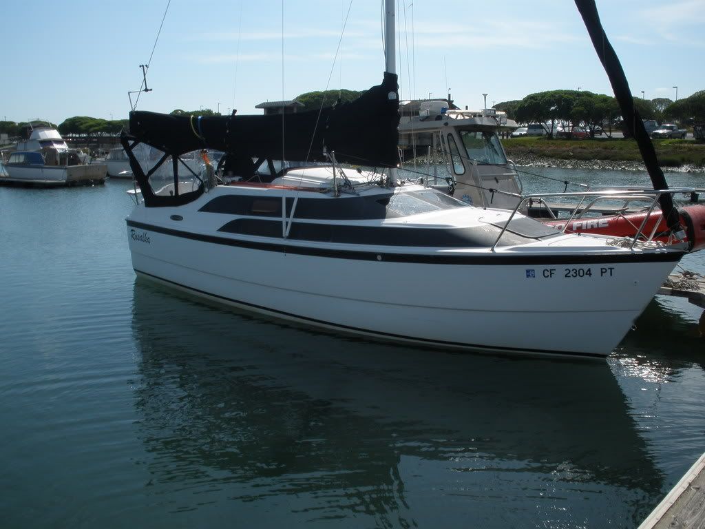

Here's a picture of Rusalka at the dock. No ballast, keel all the way up:
As you can see by the black stripe in relationship to the water, it appears parallel.
Now with ballast and keel all the way down:
Clearly, there is a slight dip in the bow. This is normal since the boat drops 3 inches with ballast in. The dip is clearly at the bow, which supports the theory of where most of the ballast is located in the Mac
I don't think this is any different than a stock
at least not enough difference to make a difference IMHO.

Thanks for taking some pics. Your M looks about the same as mine on the water line. When no one's in it, it sits slightly bow-down (w/ ballast full). I'll have to pay attention better when I'm out in stronger winds to see if it does the same thing. I got no other ideas

Wow! Wow! and holly cow! Your bow tilts up w/o ballast and perfectly level with ballast in. I was halfway kidding a while back when I said that perhaps a huge, heavy, massive, monster engine on the transom may actually improve the Mac's sailing performance.... but looking at your pics, it might just be a good way to ballance the hull. I would seriously consider that Etec 115 if I wasn't casualy shopping for that Beneteau or Catalina :

Thanks for posting the photos guys. My boat sits similar to Leon's: bow down at the dock with ballast in. I think it sails better with more weight in front. I've sailed several times in light winds with no ballast and surprising found no improvement in speed compared to full ballast.
