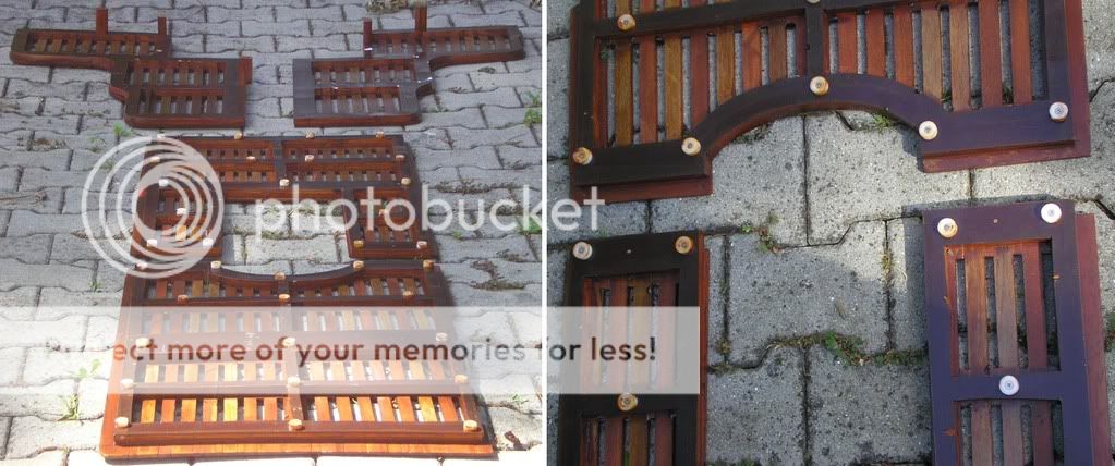

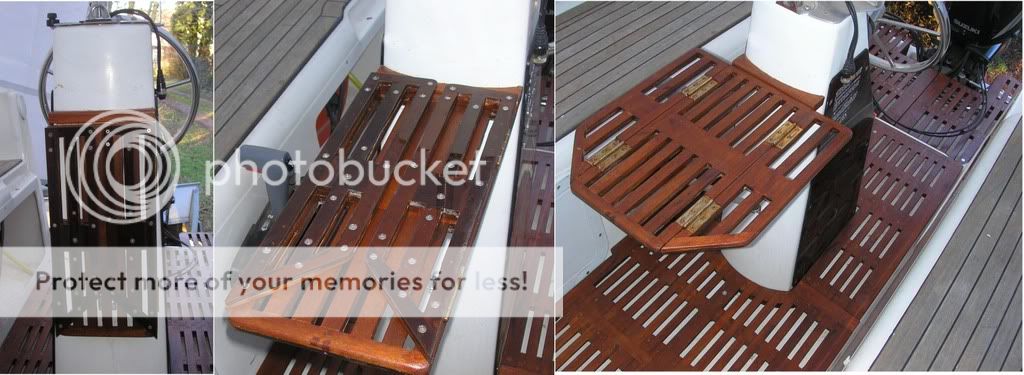

..as requested here are some other pictures of my teak work
The teak on the seats is custom made.
The floor and the cockpittable are made by me, both more or the less the same way.
Teak strips are mounted on frames.The frame for the floor was made from 16mm (3/4 inch) watertight playwood as it is used for the loadfloor of trailers. To allow the mounting the floor consists of four parts.
The frame of the cockpittable was made of 6mm (1/4 inch) Acrylglass.

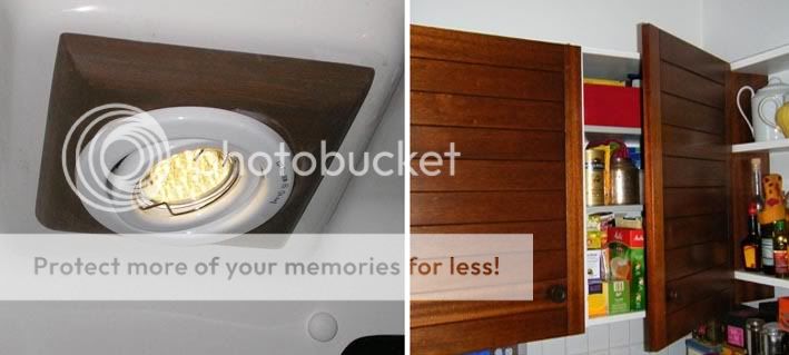

The internal lamps were changed to LEDs however now they are not as bright as the original ones, to be honest they are to dark :( but in my opinion they look better :) .
The last picture is showing what are my teak strips made from, a 45 years old kitchen was canibalized :) . By this time in Germany sometimes kitchens (the expensive ones) were made of solid teak. However it was a hard work as the teak had to be splitted horizontallyfirst to get right the thickness for further processing.

Rainer - absolutely awesome!

I love that cockpit table Rainer. Well done! :)

Beautiful Teak Rainier.
