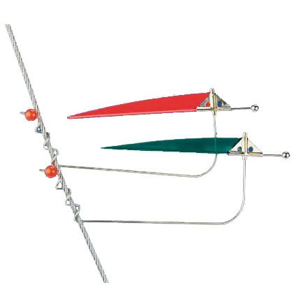

I agree with Highlander and Parrothead. These work fine for me. Attached about 7' up on the shrouds.

The pointers are not useless on the rotating mast if you think about it.
Instead of spreading them to show the normal 45 degrees on a fixed mast, try this out.
Bend them in closer to have a total spread of 20 degrees, with each one being 10 degrees from the centerline.
(Not the 45 degrees from centerline you'd normally expect).
Mine almost touch each other set at 20 degrees.
The mast rotates about 55 degrees from the centerline, and there lies the trick.
That means the "windward" indicator will now be at 45 degrees to the centerline and the "lee" indicator is at 65 degrees to the centerline
after the mast has rotated.
The space between the two is the mast angle of 55 degrees, usually about the best a genny will do in a tack.
It works, if you want the indicators.
