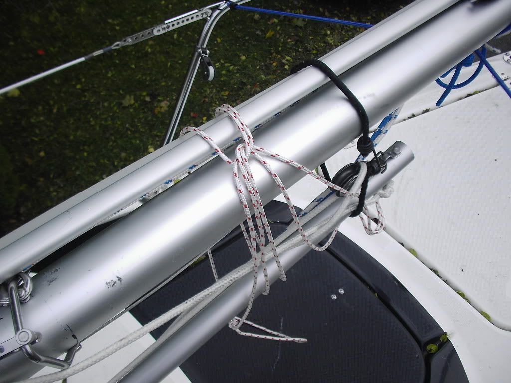

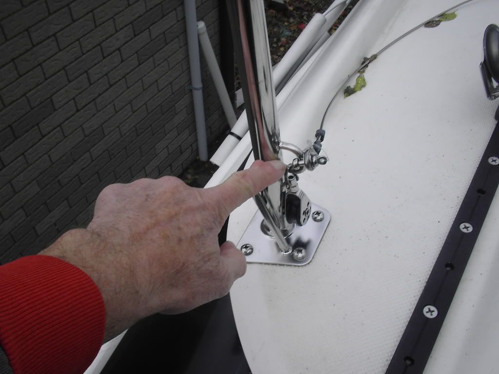

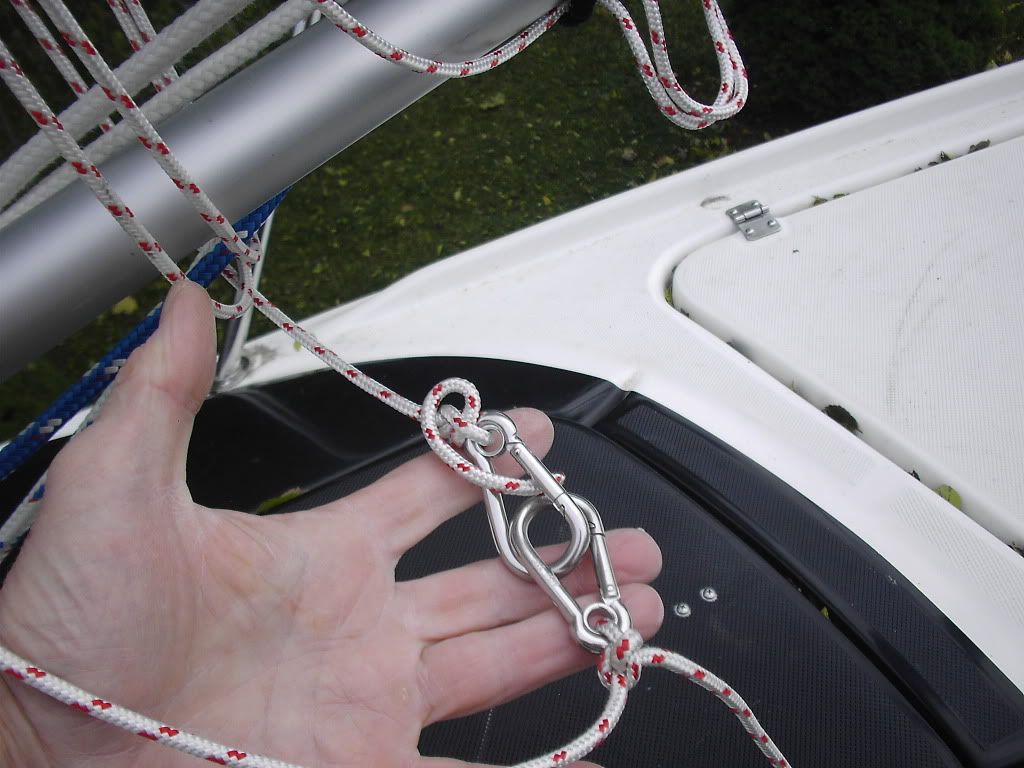

Here we go this pic shows where the baby stays go on the gin pole at the end underneath these are extra baby stays that I added to support the gin pole not the mast . my mast raising system came with SS wire baby stays to support the mast
http://i844.photobucket.com/albums/ab1/ ... 010002.jpg
Here is the SS snaps from Crappie Tire around $4
http://i844.photobucket.com/albums/ab1/ ... 0003-1.jpg
Gin pole baby stays wrapped around mast & furlers for storage
http://i844.photobucket.com/albums/ab1/ ... 0004-1.jpg
They attach to the stanchions at the same point as the baby stays for the gin pole mast raising system you can see the SS wire baby stays for the gin pole here but they attach to the mast about 7ft up from the mast base
http://i844.photobucket.com/albums/ab1/ ... 0005-1.jpg
Hope this helps it really stabilizes the gin pole and keeps the gin pole from bending way over as the SS brkts on the base of them are not very strong and it gives the gin pole alot more support

Highlander - it sounds like you have two sets of baby stays, one for the mast and one for the gin pole - I hadn't heard of that before, but I can see where it wold help stabilize the gin pole as well as the mast. I read Dave's post to mean he had one set of baby stays, which he attached to the gin pole. I don't think that set-up would help stabilize the mast when lowering. Unfortunately, Tanstaafl is packed away for the winter, so I can't get any photos.

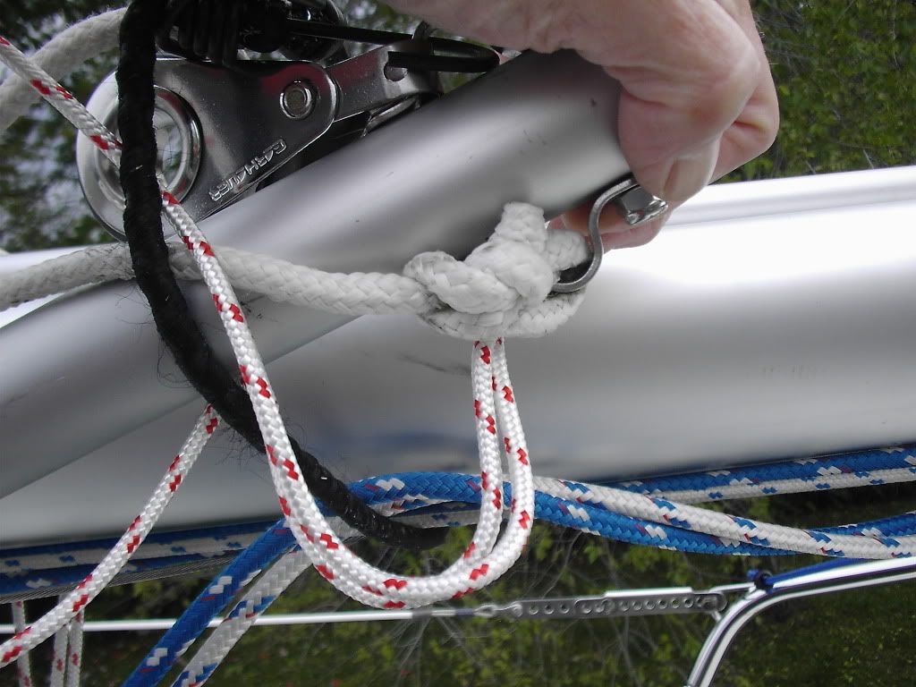

Not sure if this will help...or further muddy the waters.
You can see the baby stays...they are SS wire with small shackles at each end. If you look closely at this photo the shackles are connected to a bowline loop which itself is shackled to the hound on the mast. Thus the baby stays are not connected directly to the mast (or the hound)...but they are connected close to the mast. I never disconnect these two shackles...they stay attached to the bowline loop on the end of the mast raising line all the time...even when the mast raising pole is stored in the truck.
And the other end of the baby stays are connected to the metal loop on the stanchions as in Highlander's last photo. When I set up the mast raising system I shackle the end of thick mast raising line (with the two baby stays already shackled inside the loop) to the hound on the mast. Then I shackle the end of each baby stay to the loop on the stanchion. Then start cranking.
