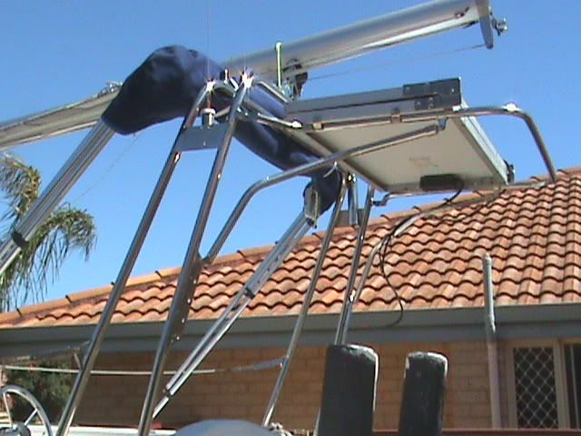

I fitted two 80watt panels on rear of my mac and they seem to be working out ok.
Enough power to run fridge and accessories and charge batteries

Wow Keith.....now that is a nice install. Fold up panels....I love it. Are those 80 watt panels? approximately 2' by 4'? That is quite a stern rail set up, how tall is that? Can you still use your ladder?
