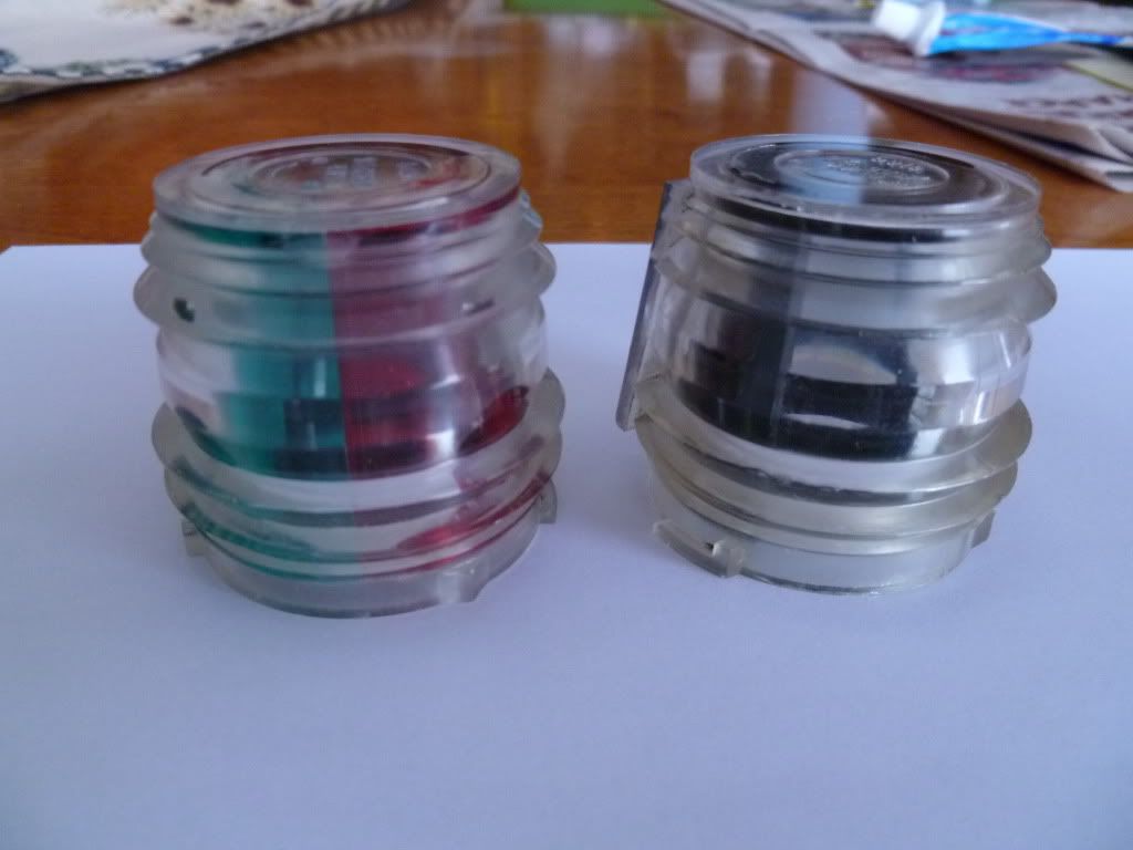

I took the lenses off my bow and stern lights. They were both faded a little. The first pic shows the before view.
http://i1109.photobucket.com/albums/h42 ... tylens.jpg

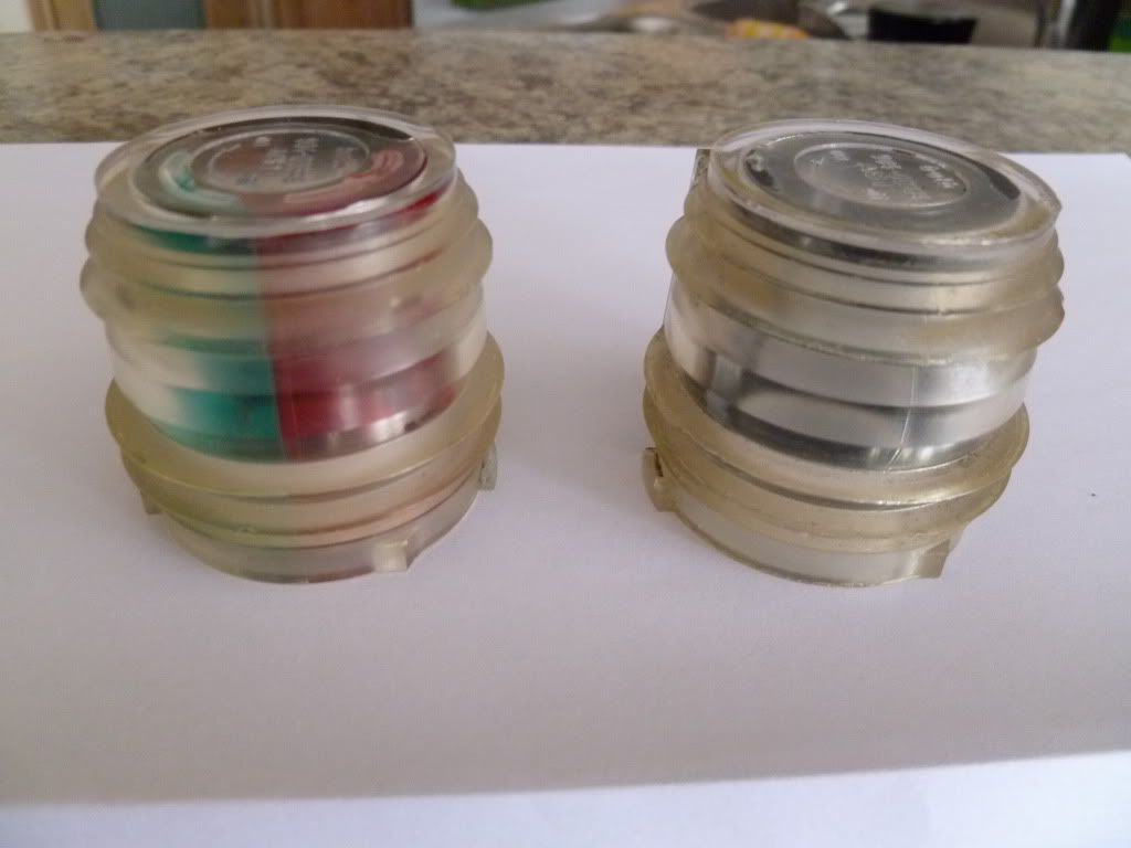

I then polished the plastic lenses. The next pic is the after shot.
http://i1109.photobucket.com/albums/h42 ... htlens.jpg

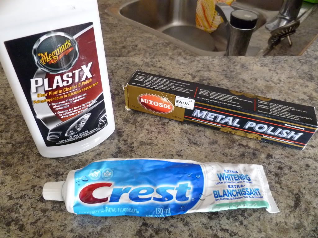

In person, the cleaning shows very well. I don't know if it shows clearly enough in the photos but it made a dramatic difference to the overall appearance. The dull, slightly yellow hue is gone and they now have a beautiful clear aspect to them. Recently, I polished the dull headlights of my daughters 95 Interpid and they came out very well making them look brand new again. Believe it or not I used toothpaste on one of them and on the other I used Meguiar's PlastX polish. I did a comparison and although both did a very good job the Meguiar was slightly clearer. I used Autosol on the rear tail lights and it worked very well also. I don't have any pics of those so you'll have to take my word, but they look brand new. So that is what I did on these boat lenses. Here is a pic of the products used.
http://i1109.photobucket.com/albums/h42 ... agents.jpg

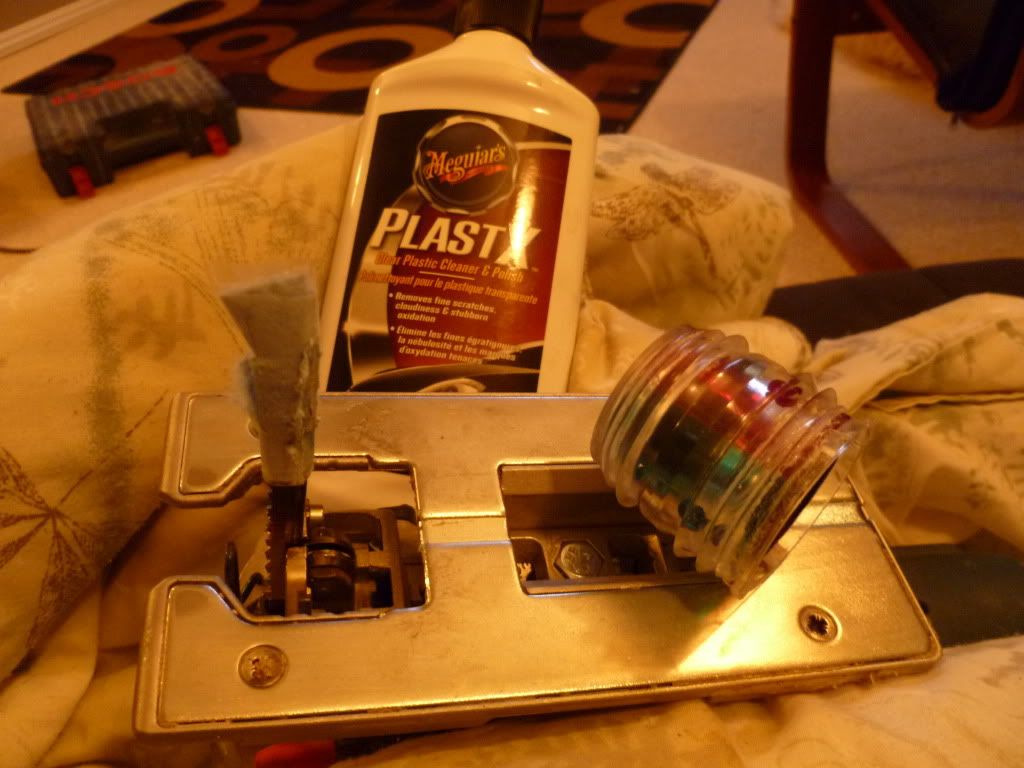

I had a PM that asked me to show how I polished those little rascals. With all those ridges they did cause my fingers to cramp up. I needed an easier way. I had a polishing wheel attachement for my drill that I tried but its circular motion was not the best to get into some of those tight areas. I needed a mechanical recipricating action to properly accesss those tight areas. I pulled out my Bosch jigsaw and put it to work. I wrapped the blade withsome cloth, then turned it upside down and supported it with a quilt. Now the blade is pointing up. I rubbed some meguiar's polish on the cloth as well as the lens. I used the back side of the jig saw blade for obvious reasons. I turned on the jigsaw and polished away. A couple of key points: Use the slowest setting on the jigsaw, keep it lubricated and you don't have to use a lot a pressure. Nice and easy and let the polish do it's job. Here's a pic of my set up.
http://i1109.photobucket.com/albums/h42 ... ingjig.jpg
Shanker

That is certainly thinking outside of the box :!: :idea: 8)

shanker wrote:I used the back side of the jig saw blade for obvious reasons.
My favorite part! :D :P
The pics do show how nicely they cleaned up! Might have to do something like that myself. (I have also done the "polish the headlights" trick, and it works very well! It doesn't take out the little impact nicks from rocks/sand, but it takes the crazing/yellowing out and makes them look much better.)

Hey Shanker -Nice job! I love it - they look lika new! :D
I’ve polished plastic up with Brasso (or Silvo) metal polish – works well if you already have it on hand, and the abrasive is very fine. A good finish with plastic requires the right combination of heat and friction. Too much or too little and the job won’t turn out right (melt!) or will take forever! Plastic watch crystals that are lightly scratched will polish up like new with this in seconds.
Another way to do the polish job of the bow light lens for those who don’t have a jigsaw is to put a bolt through the centre of a cork which is sized so as to jam snugly into the light. Chuck the bolt into a fixed drill and polish away. 8)
A similar, edged polisher to Shanker’s will get into the grooves, but an ink eraser, which can be shaped easily, will also do well for initial roughing. You can easily control the polish rate and heat buildup by varying your rpms and pressure. Keep it moving.
A long, thin piece of polish-impregnated cloth held across the lens between both hands while the drill is running will get into the bottom of the grooves as well. Wrap the cloth around maybe 180 degrees, but not more, because it can catch and grab, and wrap itself around. Not so bad, maybe, if you aren’t wearing a tie! :cry:
