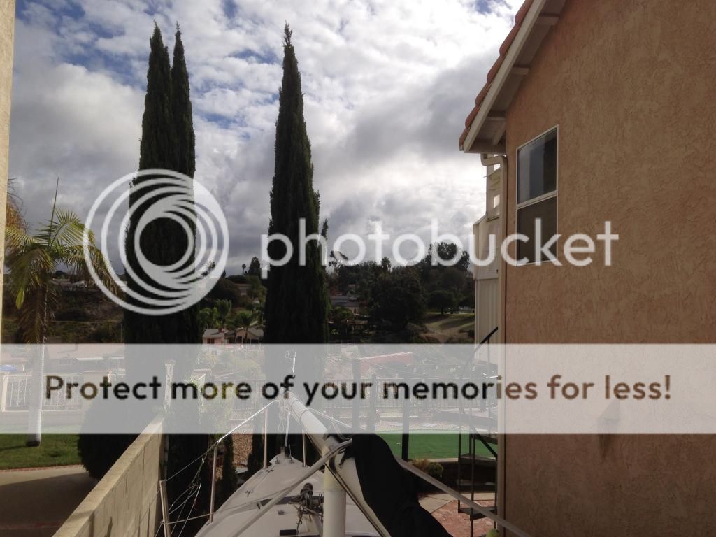

Dirko is a new member who was concerned about a good seal on the bow vent as well he should so i promised some pictures of my electric bow vent valve as soon as the rain stopped.
The rain stopped - (rain is a big deal out here) so I went out to the boat:
As I crossed the transom I remembered my PVC mod to the motor cables that have kept out ALL water and after the hard rain we had last night I wondered if any drops of water got into the bilge:
checked the bilge and after three days of rain it's dry as a bone! Not a drop!

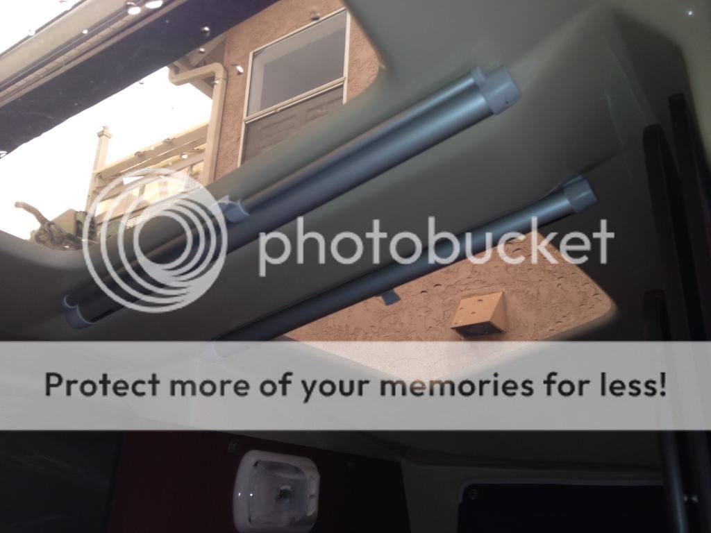

So I started forward to get a pic of the ballast vent when I remembered I had installed shades on the windows so i though i might show that:
Here is how they look when the shades are down:
Oh, as I got further forward I remembered I put shades on the front windows too - they look like this:

I really can care less about closing the shade when I'm on the head but my wife insisted because at a dock she could see people walk by and I told her the windows are too dark to see in but for her this is how the shades fix that:

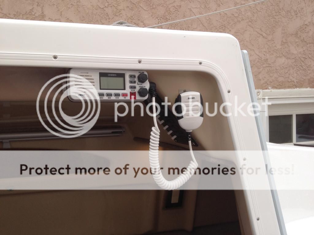

And moved the radio in a place where you can actually hear it when someone calls you. I had a Navy vessel trying to hail me once and I did not hear them until I went below:

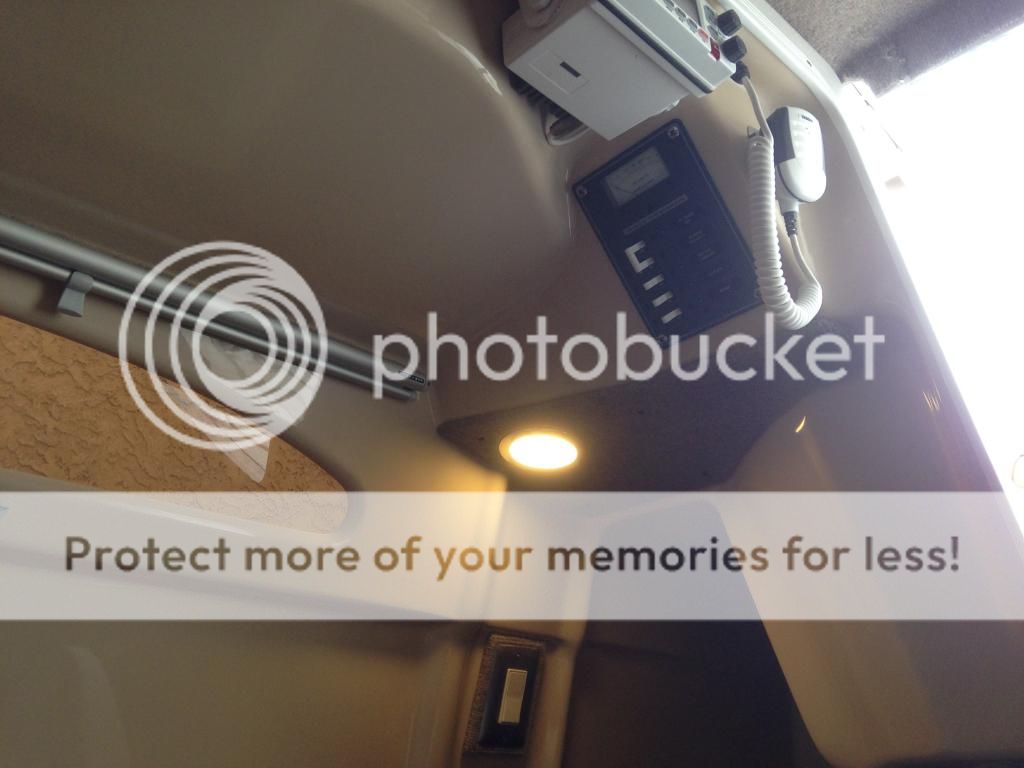

And that old radio position under the 12 volt electric panel was a real head banger!! (ouch!) This is much better, easier to see, to hear, and to reach:
