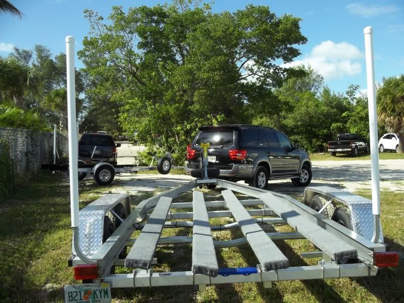

I'll have to look sometime, but I"m pretty sure my axles would catch the board before it hit the road if the line separated while trailering. The longitudanal bunks have a lot more support for your mac, not to mention that it is inline with the stringers in the hull. I think the stock mac trailers had those sideways bunks just to save weight and cost if you ask me..the boat is MUCH better supported on my new trailer (probably triple):
