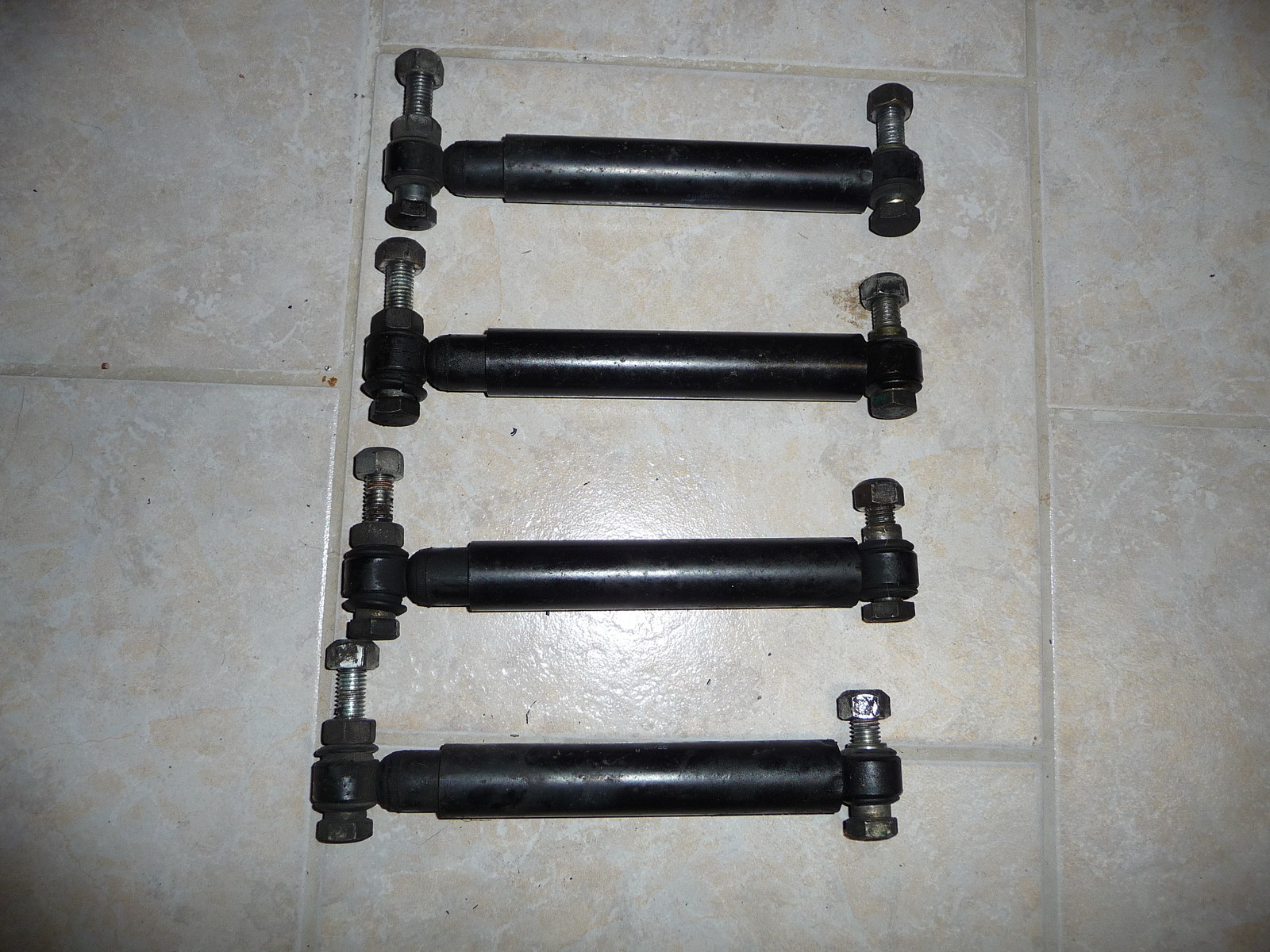

I dont know what you mean with the "load balancing". But your are right, here in Europe the tongue weight is not as much.bobbob wrote:I've been doing a bit more reading about European tongue weights vs US tongue weights. It seems the standard in europe is much lower (5-7%) because the assumption is that the trailer will be dual axle with some kind of dynamic suspension/load balancing between the axles (so that the up and down movement on the hitch is significantly damped). Is this a feature available on aftermarket trailers over here?
With my 27 years old Mercedes 300TD (w124) I tow my 2axle
Just Germany gives you am max speed of 100kmh under some conditions, and one is that you have to ad some extra shock absorber/dampers to the axles like these ones
Re: Nice video of tongue weight being too low, bad outcome
While kurz's tongue weight seems incredibly low, the 50 mph tow speed is the figure to note there.
I notice a big difference in squirrel factor between 60 and 70 mph at 350 # tongue weight
