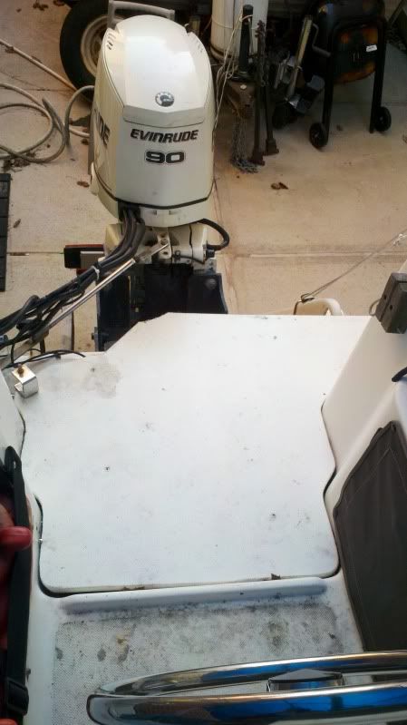

Gazmn,
18mph unballasted makes it sound like there is something wrong with your motor setup: if our motors are producing the same power your X would have to be significantly heavier unballasted than mine is with full ballast. While you sure have a lot of stuff on there, is that really a possibility? With 2 adults and 3 kids and camping gear on board, I WOT at 20mph with ballast. Actually, if I empty the whole boat out and run solo, I still get 20mph ballasted and 24 mph unballasted. The extra several hundred pounds makes essentially no difference. However I once went out with six solid adults, beer, holding tanks, etc. and that brought me down to 18/19 mph with ballast.
I am sure you have been through all the prop options? I currently have a 14x11x3 Bombardier aluminum prop that turns at around 5k RPM. I tried a Piranha composite 14x11x3 prop and lost a lot of speed while gaining RPM. Your post on the Hunter Edge just convinced me to try a 14x9 next year to see if I can maybe get another 300-400 RPM and maybe a mph more. I don't believe Hunter's numbers for a second...it's like Macgregor talking about 20+mph with a 50 horse. The tests were surely rigged in the boats' favor.
VKMaynard posted something about a specialized prop that, if I remember correctly, was fabricated for his boat and helped get him to 30mph? Victor if you read this can you remind us of the détails, or maybe I'm imagining things?
Gazmn, how high does your boat float in the water...or maybe I should say how low? With 6 adults on board and ballast in, my cockpit drain hole in the back of the transom is submerged more often that not, when anchored in light waves. Under those heavily loaded conditions I have noticed the "pit" backfilling with water during wave action then draining out again. Amost gave me heart failure the first time I saw that happening.
Given all the evidence out there, I have to suspect your motor is not performing as it should. If I was you I would probably try the other 90HP before investing in the 115. At least that way you could isolate if it's your boat or the motor, assuming you have a good prop.
Is your motor mounted at the same height as mine? It's a bit hard to see in this photo but have a look:
From the picture you posted in the Summer 2014 thread, it's hard to see how your motor is mounted: there's a black blob in the photo that could be anything.
It really seems like there is a lot of power variations with the Etec90. There are a few old posts about someone in Australia actually having Bombardier reprogram the motor to get another 10 or so HP out of it, and then there's Bahamabound, who's Etec90 can swing a 14x15 prop or something crazy like that. I'm somewhere in the middle.
Oh, and the dealer seems to have fixed the starting problem. "loose battery wire" according to them although I am not sure how that makes any sense: the motor often would crank for a long time but just wouldn't fire when it was cold. When it was warm it would usually fire right up, but sometimes would take a few tries. Anyway, whatever they did, I went to winterize it on the trailer a couple of days ago and it fired right up in near freezing temps...so here's hoping that that problem is gone.

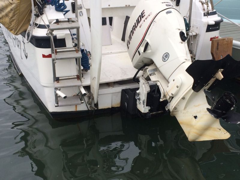

This is relevant to Starscream too so I'll reply here rather than start a new thread. It's a 10" jackplate which raised my eng roughly 5"s. & freed up the back porch. See mod.Gabby_SC wrote:Gazmn, Sorry for taking this thread in another direction. Could you tell me about your picture in the 2014 Summer pics. Is that a setback or a jackplate between the stern and engine?
Starscream your boat & eng are a few inches higher in the water. Re: the below waterline hole.
I have that prob too. & it scares the hull out of me too. Im thinking of plugging it to be safe.
I raised my bottom paint line to above ur black stripe -notice I dont have stripe.
The water level comes up to the bottom of my white bracket
Im considering raising bottom pain line again.

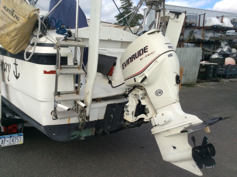

This is the boat in water at mechanics. You can get an idea of my float line. I lightened the pic so you can see better.

Thanks for that. Somehow it's comforting for others to be having the same problems as I am.
When you go to sell your boat, you can tell the potential buyers that it used to be owned by Carlos the Diamond Smuggler. "Boat's in excellent shape but doesn't accelerate too well, almost like there were weights hidden in the bilge or something".
While talking to my dealer about my disappointment with top speed, we discussed the vertical position of the motor with regards to the waterline. While I didn't follow the reasoning exactly the takeaway was that the vertical position in the water was very critical and there are some important guidelines to follow: too deep or too shallow and performance will suffer.
Your prop looks a bit beat up in the photos. Curious to know your prop size & RPM
Does the stabilizer plate help things?
I think I am going to plug that cockpit drain-hole as well. Some sort of removable thing that I can put in easily when going out on a loaded boat. I wonder if I can tap a thread into the fiberglass or if I should just save a wine cork.
