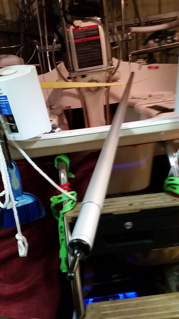

That was done by the PO - need a longer one for my genoa? 8)

12 ft telescopic whisker pole from Forespar. Long enough for the 110, but too short for the genoa. http://www.westmarine.com/buy/forespar- ... -l--111179 Spike or latch versions. But you need to mount a ring on the mast.
The rule of thumb I've always gone by is the whisker pole should be as long as the foot. The 110 has a foot length of 13-1/2 ft, and the genoa is 16 or 16-1/2 ft. No harm in using a shorter pole, but if it doesn't pole out as far as you'd like, a longer one is the order of the day.

The whisker pole that makes sense on our boats is the ForeSpar 6-12 foot telescoping one. Lightweight, affordable, almost long enough. Then Matt has his swiss army boat hook :)

Tomfoolery wrote:What kind of whisker pole is it?
The only one I've owned was a line-control Forspar on a larger boat I no longer own. Wish I had kept it, but it was too big for the 110. Probably about right for the 150. Got it used for cheap, but new ones of that size and style are closing in on $1k.
It almost positive it is an older Forspar. Normally I would just step out the back door and check it out for you but the boat is about an hour away right now. I should be able get you a better answer later in the week.
