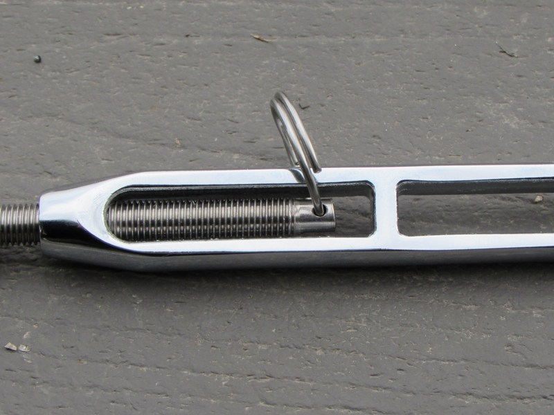

I experimented with a ring (see the picture) but I dont think it would survive long inside the furler. Need something better given that this will be somewhat of a pain to inspect.

I've got both a split pin and tie-wire in our turnbuckle. Hopefully between the two that'll keep it secure!

Another possible option to throw out..
This is 19 guage stainless steel wire in a "figure 8" so loops through the bolt hole twice. It seems very rigid..

Walt, the figure 8 with stainless steel wire is just what I had in mind. I will keep all the twists tucked inside the turnbuckle to minimize the chance of the turnbuckle snagging the inside of the furling drum.
