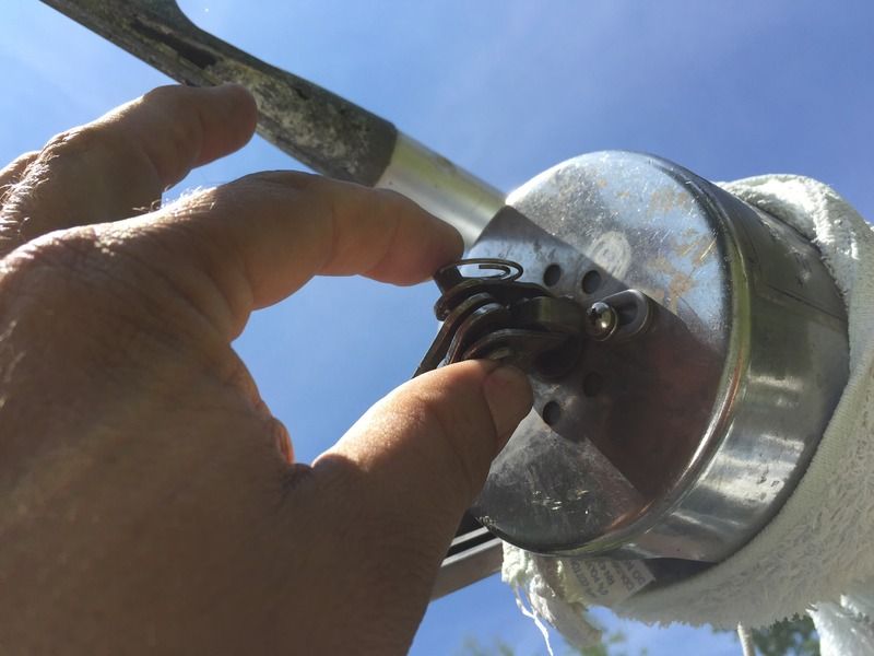

I have a Johnson lever on mine but you can see the toggle inboard of my fingers. Your forestay plate in your boat should attach where the lever on mine is.
You should have no shackles between the toggle and the plate, not even the one you had before you added the extra. The forestay typically has 300-400 pounds tension on it.
It's really amazing the two screws held your mast up. I'm guessing PO sailed in serene lake conditions or didn't use furler
Nice catch Tom....I completely missed it on the picture. You definitely saved a mast and probably an injury or two

Are you saying that I probably have one of these inside the furler drum of my X??Tomfoolery wrote:Here's the part on BWY's web site. P/N 3106-000. http://www.bwyachts.com/
For $36 plus shipping, you can't go wrong, even if you don't need the whole turnbuckle. But you can see the missing piece straddling the tee-bolt. Everything but the toggle is (or should be) up inside the furler. The open end of the turnbuckle takes the stud that's swaged onto the forestay wire.
And all I have to do to not kill myself attaching the forestay is loosen that a half inch???
Where were you five years ago!!

Mine, right after I got it. OP: You can just see the female part of the toggle in that picture. The strap is removed, and the drum is slid up the foil, after pulling the one pin that holds it down.
But I've only adjusted it once, when I replaced the forestay and tuned the rig. I just crank down on the MRS to make the stem fitting pin.
