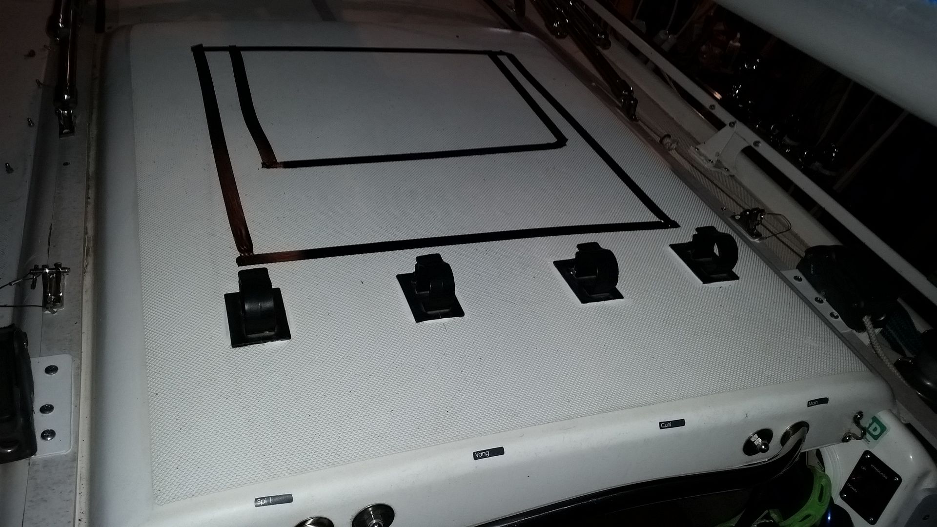

or u could raise the height of the sliding hatch by cutting out the center say 26" wide & 50" long or what ever the max length u could go with then re - attach the cut-out section back on with 4 strips of alum reversed channel say 3-4" high depending on how much more head room u need :arrow: :idea: " this would be a very cheap mod as all u need is the channel & hardware " :wink:
or just raise the whole sliding hatch really not much involved in doing that & gain lots more head room
or u could do something like I,m gonna do a little more money cut out the hatch I,m going with the bigger one now as seen in my pic
& installing one of these . I got it when it was on sale for a $180. cheaper
http://victory-products.com/collections ... s/ry03-280
PS also u can remove the sliding hatch & replace it with that nice sleek hardtop u designed :) :wink:
