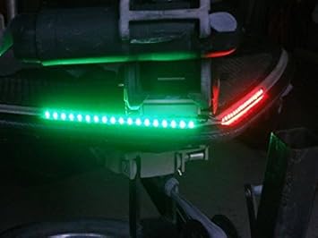

the cost of whole new LED Nav Light Assy vs buying a single expensive LED and then maybe only to find out it won't fit or work. The current red/green bow light lens is also stained.
For the bow I'm going to give this a try...yeah I'm going cheap here. 1/2 the price of an Attwood. I may regret it but I'll also dismantle it and further waterproof with silicone. https://www.ebay.ca/itm/MARINE-BOAT-YAC ... 2749.l2649
Another inexpensive option would be LED light strips. Possibly mount them just under each rub strip. I would further stick some clear 3M clear tape over these light strips. They are certainly bright
if you really want to be seen.
https://www.ebay.ca/itm/2x-Boat-Navigat ... 1438.l2649
For the mast. 9 LED's
https://www.ebay.ca/itm/1x-MARINE-BOAT- ... 2749.l2649

Re: LED lights for cabin and navigation.
Those are not navigation lights. They don't limit the sector of visibility from dead ahead to 22.5 deg. abaft the beam, nor are they USCG approved (and couldn't possibly be). Sidelights and masthead (steaming) light dim out rather quickly with angle beyond the 22.5 deg., and at that angle the stern light takes over, so other vessels know which way you're pointed, and therefore who's the stand-on vessel and who's the give-way vessel. Showing red or green far beyond 22.5 deg, plus the white stern light, will confuse the heck out of other skippers, and will be a liability in court if someone runs into you (or you them).mac n cheese wrote:Another inexpensive option would be LED light strips. Possibly mount them just under each rub strip. I would further stick some clear 3M clear tape over these light strips. They are certainly bright
I'm also leery of non-approved white nav lights, as I've seen some bluish LED masthead and stern lights, and they're confusing at first because they're not 'standard' incandescent color, and therefore not what my eyes are tuned for when on the water at night. There are LED white lights (and retrofit bulbs) that conform to the color spectrum required by the USCG and ABYC, but without actual approval, there's no way to know what they really look like without buying and trying. They look kind of blueish white, but that's a computer screen, so who knows.
Just sayin'.

Great point!!Tomfoolery wrote:Those are not navigation lights. They don't limit the sector of visibility from dead ahead to 22.5 deg. abaft the beam, nor are they USCG approved (and couldn't possibly be).mac n cheese wrote:Another inexpensive option would be LED light strips. Possibly mount them just under each rub strip. I would further stick some clear 3M clear tape over these light strips. They are certainly bright
Tom, do you know the regs for the white color specs? As you mention, the high temp white looks different. There is a uniquness to their appearance which in a way I find better as they don't look like shoreland lights. Are they legal though? I only recall a minumum viewing distance, angles and general color requirement.
Also, with the rotating mast of the M, a prudent captain would secure the mast centered for correct steaming light angle while under power.
I don't know why they are allowed to sell these strips as nav lights. Yes, they are cool, but not legal.
You may say so what? They are legal enough.
When there are injuries and lawyers, COLOREGS matter.
This famous and scary case where they charged the SAILBOAT for the accident because the drunk deputy who hit them claimed the nav lights weren't illuminated. The lawyers sent the nav bulb to a crime lab to determine if the filament was energized before the collision. THAT is how crazy and important this stuff is when criminal charges are at stake.
A smart lawyer could also say your green looked aqua and red looked pink (because high temp LED) and get you charged with an accident. Lord knows what they'd do with strip lights as navs. Yea, old Billy was right, the first thing we do.
https://www.amazon.com/Green-Blob-Outdo ... B00NHBHRV4
In the "questions" the seller clearly states they are not legal nav lights. As Tom poins out, they need to have a specific cut off angle. As cool as they are, this simply can't be legal (and shouldn't be).
