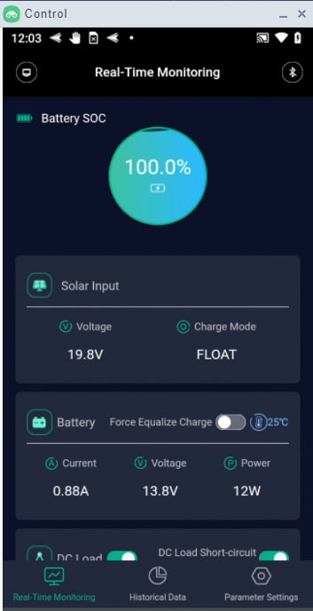

This year I upgraded my solar panel from 80w to 100w monocrystalline panel. It's smaller and is more efficient.
With that, I also updated my controller to a MPPT controller with bluetooth.
I also have an old android cell phone that I leave on the boat that I can remote into and connect to the controller to see what the conditions are.
My boat is 90 miles away so it's really nice to see at any time what the charging situation is like.
Checking the solar controller right now I see batteries are 100%. It's a little cloudy out but I'm getting 19.8v from the panel and my batteries are at 13.8v so I assume the combiner has joined both batteries.
It's putting out 12w which I assume is the load from the Android phone and WiFi camera that is connected to the house battery.
