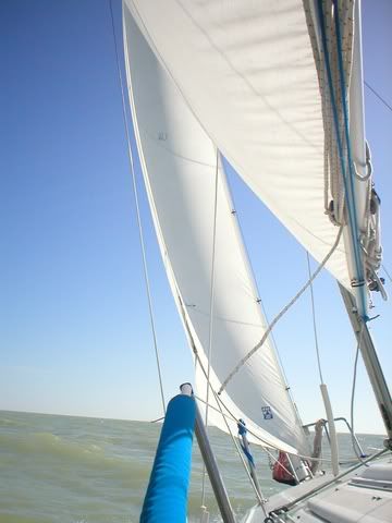

pvc anchor
I used some 4" pvc pipe clamped to the pulput, and a mesh bag for the rode...
the pvc holds the anchor nicely for quick launch.
a milk crate also works well.
