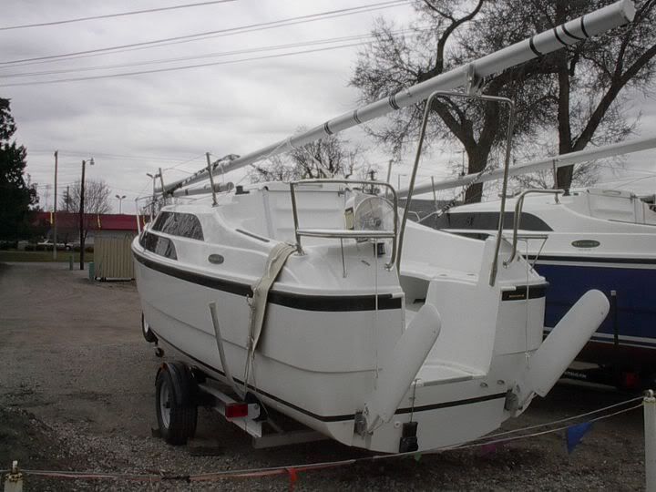

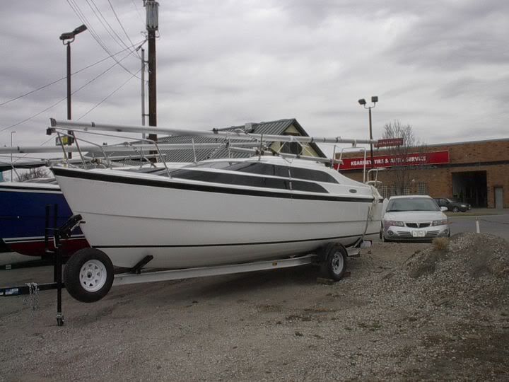

Well - my boat is sitting at the dealership getting prepared and a motor installed. I should get it 2nd weekend in April.
Hope it works, its the first time I try to post pictures:
Enjoy!
LOUIS B HOLUB
Posts: 1315
Post by LOUIS B HOLUB »
Pics look great(nice alum. trailer too)...hope you send more when shes in the water.

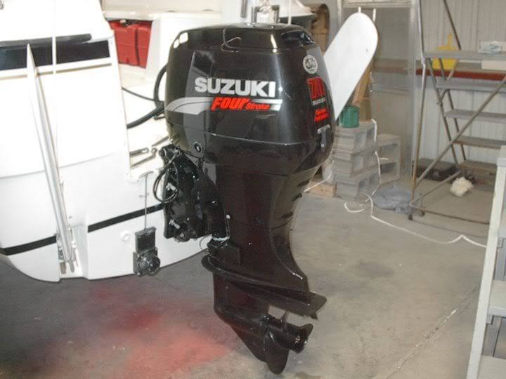

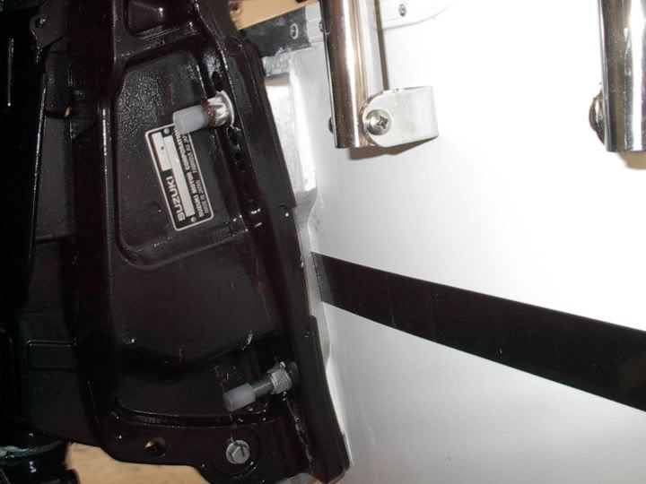

2 more pictures I got from the dealer after the engine install, tomorrow my boat will leave the cold weather in Nebraska and will be heading down to Naples - Florida! I guess Sunday...

Just called the dealer, I completely forgot to think about the prop - he put a 14x11 on the suzuki 70 4stroke - is that an acceptable choice or do I have to change it?
Hans

Hans - my 50 HP is slightly overpropped with that 14x11, if you have the same transmission ratio as my BF I would say that is a good prop for your 70HP

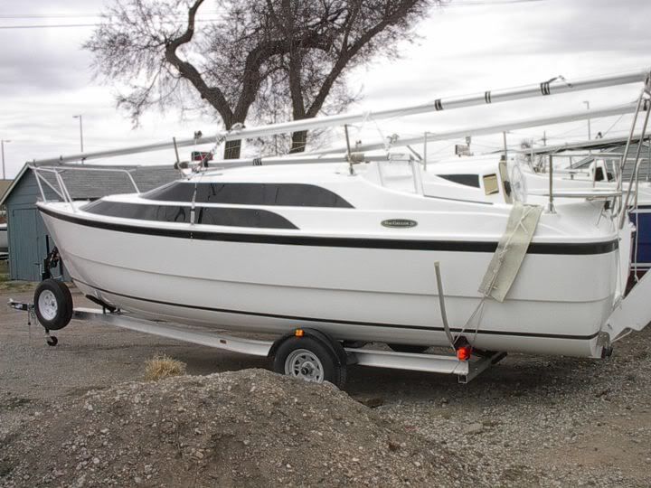

She is here - sitting right next to my house, mast is up for the first time and everything sees to be o.k. The delivery guy, an employee from supersail was very nice and helpful. But I never saw a boat with so many bugs on it -but well, it came 1750 miles down the highway to Fl! Took pictures, but I guess I posted too many already and everybody on this board knows what a 26M looks like.....

Loefflerh wrote:Just called the dealer, I completely forgot to think about the prop - he put a 14x11 on the suzuki 70 4stroke - is that an acceptable choice or do I have to change it?
The Suzi-70 could handle a 12 or 13 pitch when brand new. However, as the boat gets loaded up and the hull gets dirty, the 11-pitch will be just about ideal.
Posts: 6796
Hans,
Don't worry about too many photos :) You haven't posted any of the M in beautiful Naples, FL. 8)
Based on this info:
DF70 Specifications
Model Name: DF70TL
Horse Power: 70
Shaft: 20
Displacement: 79.2 cu. in. (1298 cc)
Weight: 357
Cylinders: I-4
Ignition: Solid State Electronic Ignition
Bore X Stroke: 2.91 x 2.97 in. (74 x 75.5 mm)
RPM Range: 5200-5800
Maximum RPM: 5800
Starter: E Start w/ Suzuki EFI
Oil Tank Capacity: 4.23 qt. (4.0 lit.)
Alternator: 12V 25A
Trim Position: Power Trim
Fuel: Unleaded
Gear Ratio: 2.42:1
Drive Train Protection: Spline Drive Rubber Hub
Standard Propeller: Optional
Available Prop Pitches: 11-26
Steering: Remote
I would say the 14x11 is perfect. I am basing this in my experience with my Merc 75 4s that is similar to your 70, but is a 1596cc and has a spec range of 4500-5500. With a 14x13 I can only hit 4500 loaded. So I figure if you had a 14x13, you would not hit the required engine spec and harm your engine.
