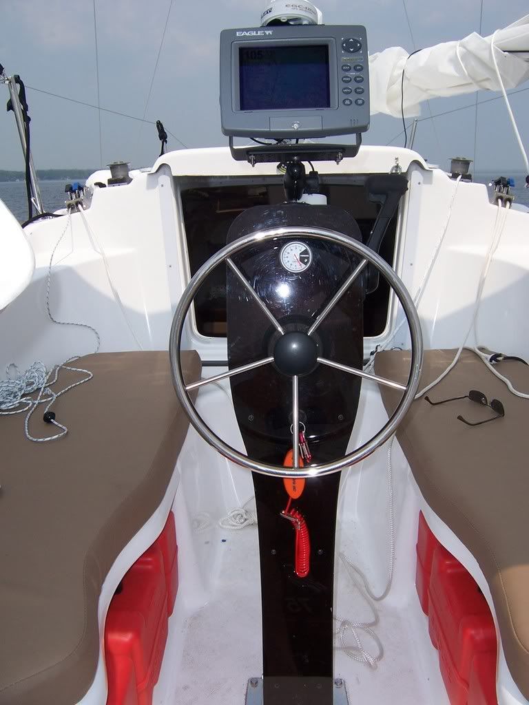

I have 2 of the 12 gal Tempo's. You can see how they fit here...
