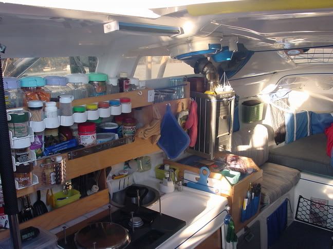

For a heater in a Mac, here's a pic from the archives, key word "theric"

K9Kampers wrote:For a heater in a Mac, here's a pic from the archives, key word "theric"
That's quite a heater ;-)
One of the features that attracts me to the Wallas 1800 is that it has two output ducts which can be directed into both the fore and aft of the boat, for more even heating. Also, by being installed under the galley, and with vents already added for bilge/storage area ventilation, it will circulate the air between the bilge areas and the cabin areas, helping to keep the bilge/storage areas warmer and drier. And in warmer weather, when no heating is needed, it has the ability to perform the same ventilation, with very low power consumption.
And one final feature that is relevant in my case, in comparison to the heater above, is that I have little'uns running about the boat, and a Wallas heater installed under the galley, with thru-hull exhaust/intake out the side, will keep all the hot bits fully out of reach, both in the cabin and on the deck.
Patrick
