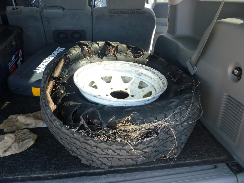

I converted my stock 2002 X trailer to a dual axle and added an additional crossbar. I did not reposition the wheels themselves just added another axle behind the original, an error I think, and now the toungue weight is higher. Not sure if it is related, but I get worse gas mileage with the dual axle trailer than with the single. About 2 mpg worse...could it be related to the tongue weight?
However the tracking is WAY better and I feel better about having backup tires! I had a blowout on my single axle trailer at 60mph and contrary to what I expected, it was a very mild event with only light shaking and pulling to the right. I was able to limp to the next exit and change to the spare. The jack from the truck wasn't tall enough to get the trailer wheel off the ground but I happened to have some spare pieces of 2x4 and was able to construct a spacer on the spot. Mental note: always carry something to jury-rig the jack. Driving the next 200 miles at night without a spare was nerve racking to say the least.
