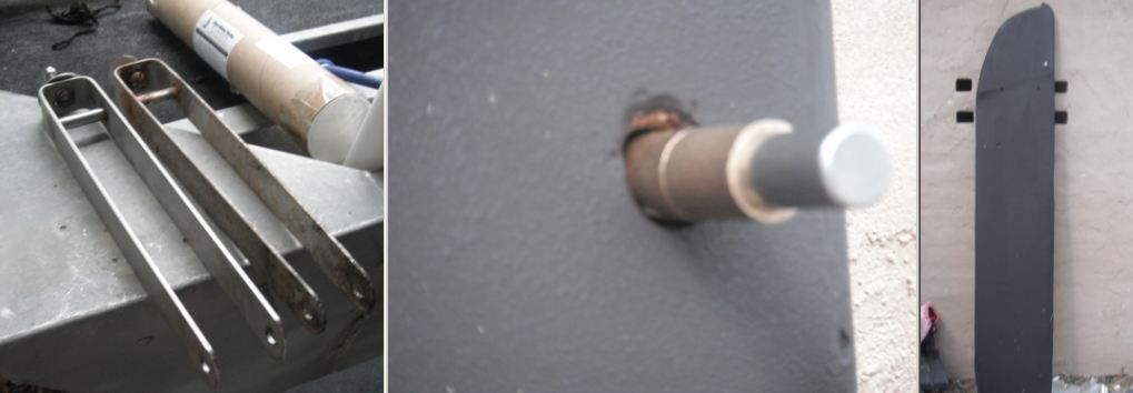

Ah Ha lol the keel wobble is real common and you will see a ton of repairs on them here is a picture of my solution it works really good
what I did is bring the new pivot pin into a really good hardware store it specializes in hard to find nuts and bolts (B&B Fasteners) I love the guys little local store. Anyway I found a socket that fit the rounded out hole almost perfect and showed them the Pin and the Socket and I said "I need a bushing this pin can go in and will fill a void the size of this socket" and the guy pulled out some drawers and looked and tried and tested and said how about this? I said its to short he said use two I said OK. anyway i had to cut 1 down a little with a angle grinder and I carefully siliconed them into the void and then climbed under the boat with the board and dropped the hanger on my head LOL Many people use copper pipe some PVC again you will have to find a solution and then repair and replace the board. OH and Make sure that the wire is not your Keel retraction Cable and inspect all that stuff too When you go to put the boat on the trailer after sailing you dont want it to drop by failure.

Ah ... so you just glued in some bushings. Good idea.
Is it a steel or iron casting ... didn't check? Well, either material, I can ream it out and fab a bushing from some beryllium bronze stock I have on hand.
Well, that's good that is a common problem. Thanks for the picture ...
What are the two piece on the left? Is that the dreaded hanger you were talking about?

you have to remember we have very different boats with some similar systems my boat uses a fiberglass board because it has a water ballast system and don't need a fixed weight. here is the sales video Motorsailors are really cool boats -http://www.youtube.com/watch?v=5jNkkz8Xop0
