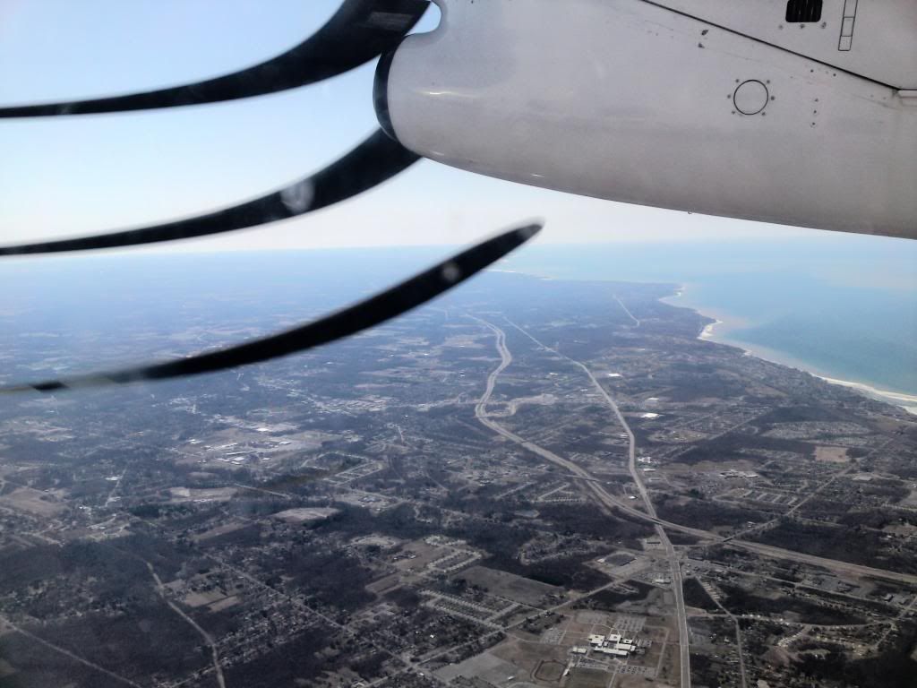

For those who haven't seen it, here is an example of what an airplane propeller looks like when photographed with a digital camera (shutter speed 1/ 1250 of a second, camera in normal landscape orientation), artifacts of the above-discussed image reading process.
Not taken in summer :o , and not taken in 2013 either :x . Sorry. :(
