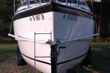

i give up, tried 4 times to get it to match smaller photo... duh, it's 11:30, and i'm fuzzy....
