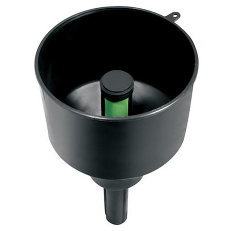

4 water in gas or crappy fuel.... I haven't yet but plan to get a water separator in fuel line and fuel tester
http://purplesagetradingpost.com/sumner ... de-36.html
.... run a water separator/filter on the fuel line and use...
https://www.walmart.com/ip/HOPKINS-F3C- ... 3=&veh=sem
... one of these filters to pour fuel into the inboard tank. I think fuel over there is now much more reliable than it use to be. Not sure I would bother with a fuel tester. Put in the inline filter and use the other filter when you get fuel.
