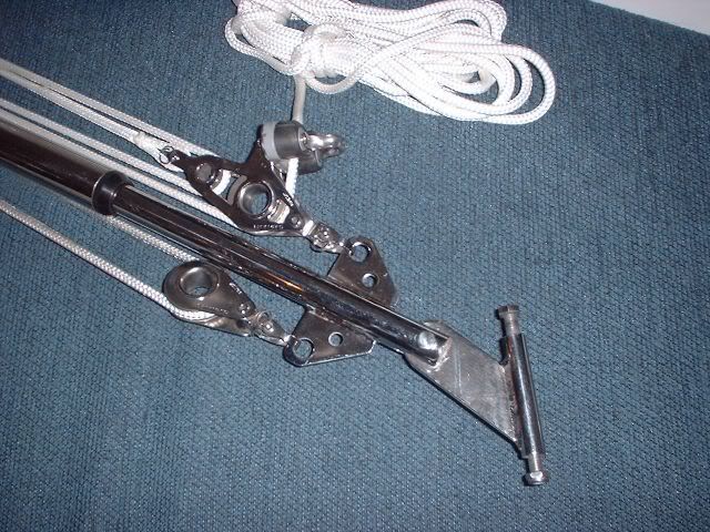

Your vang is probably 4:1, the standard dealer-option item. Garhauer is the main rigging supplier to both Macgregor and Catalina. They sell high-quality stainless rigging at very low prices (since they don't do all the R&D or Marketing of Harken, Schaefer or Ronstan). Just guessing, about 15% of Macs have upgraded to Garhauer's RV.
Go down their catalog page to find Rigid Vangs. Available at $250 in 12:1 purchase, your choice of length. Phone them direct and explain the positioning of your dodger. They operate partly like a job shop ... it might take them 4 to 6 weeks, but they'll make up anything you ask for at catalog pricing.
Garhauer Rigid Vang
Garhauer Buying example: I coveted Harken's two-speed mainsheet, 3:1 and 6:1, which would be ideal for a mid-boom traveler, but it was priced at a half-boatbuck. Phoned Garhauer to ask if they make one and the receptionist said, "Hold please, you need to speak with Guido." When he got to the phone and heard my plans, he asked height of my planned traveler, suggested how I'd want the dual-cleats arranged ... six weeks later it arrived, custom fabricated, cleats welded to match my installation, $150. Earlier thread: Upgrade from the stock MacGregor mainsheet
